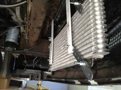

    as some of you know at SAR just waiting get in the place my trans hit 240!and thats cause it was cold that day.
    so i did the tru cool install this weekend...does badass of corse while driving stays at 130-160 ,but again if im parked at idle the damm temp rises...earlier i hit 189...
    heres a pic of location,as i have no room up top cause of intercooler.
    i think i can squeeze it in between intercooler and ac condenser but not sure if it would even cool since its blocked.
    next thing ill do is add a fan or 2!!

    ya, not getting any airflow while standing still, add a couple small fans to it to help.
    or fit it between the condensor and radiator.
    Yea get some fans. Its upside down

    I mount all of them that way. You use less hose that way.
    yea going to get some fans

    it goes either way!
    lol yup hose it came with was perfect lenght
