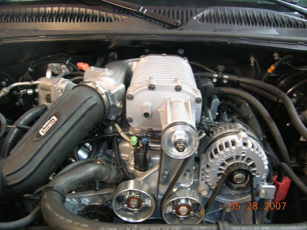

    Hey guys as requested here are some pics of my 2005 CC truck that I've been building. I have a iorn bock LS1 5.7 L, with stage 2 WCCH heads, a 218/224 duration 562I 567E 112LSA cam and a Radix with 8lbs of boost. Heres a video from this past weekend at a local event. The track is a 1/8 mile track. It's the only video I have of it racing. I'll post up a 1/4 mile vid as soon as I get one.

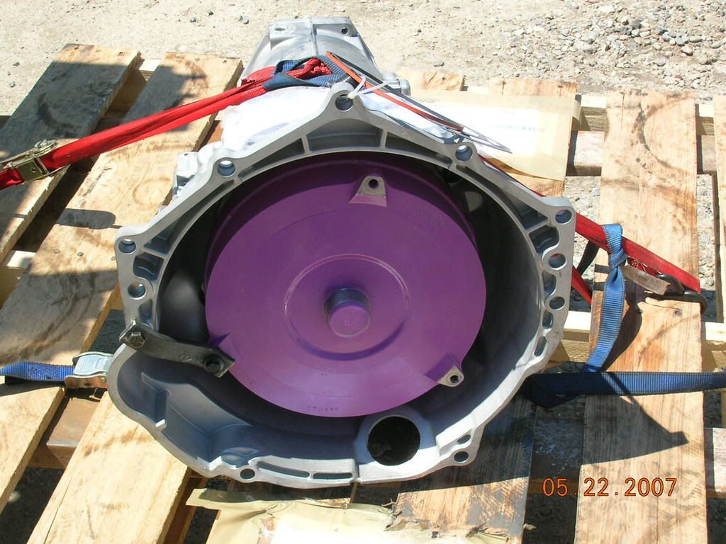

    The first tranny from FLT with the M300 billet steel input and output shafts.
    Pics of the engine/engine bay
