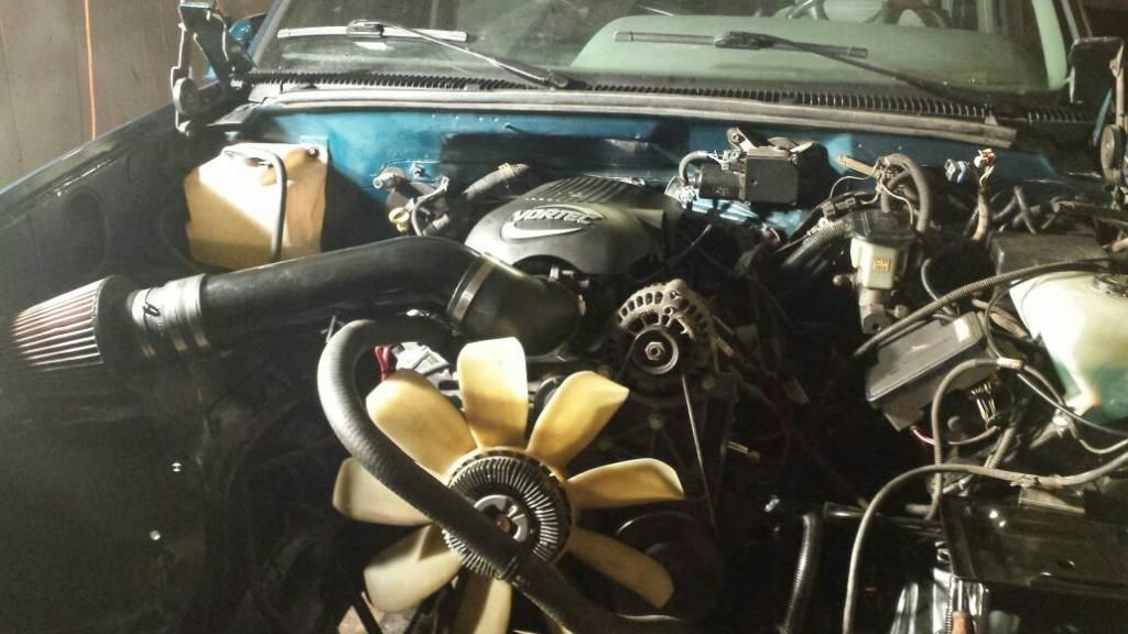

    Got the engine/trans and transfer case dropped in last weekend. Wiring harness came today and I have most of It hooked up now. Im running the stock 1995 241 transfer case. Does anyone know the best way to hook up the vss on this to the ls wiring? Do I just need to splice the old plug onto the new harness?
