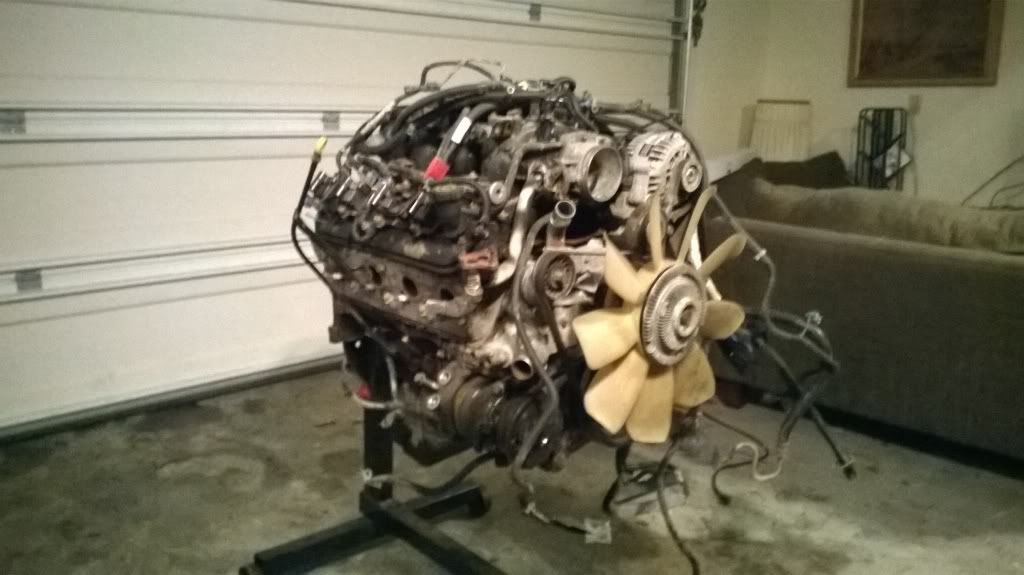

    Motor on the stand with wiring harness still attached
