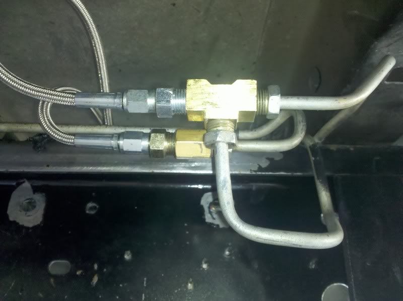

    If I remember correctly all you need is a 5/16 IFF coupler for the rear and a 5/16 IFF tee for the front lines. A couple lines may need to be slightly bent but everything will connect up nice in the stock ABS location. Makes bleeding brakes much easier...

    Here is a pic of one of the ones that i've done. This had line locks also..
    Quote Originally Posted by DBRODS View Post
    so there's no need for a proportioning valve, just a coupler & a T?
