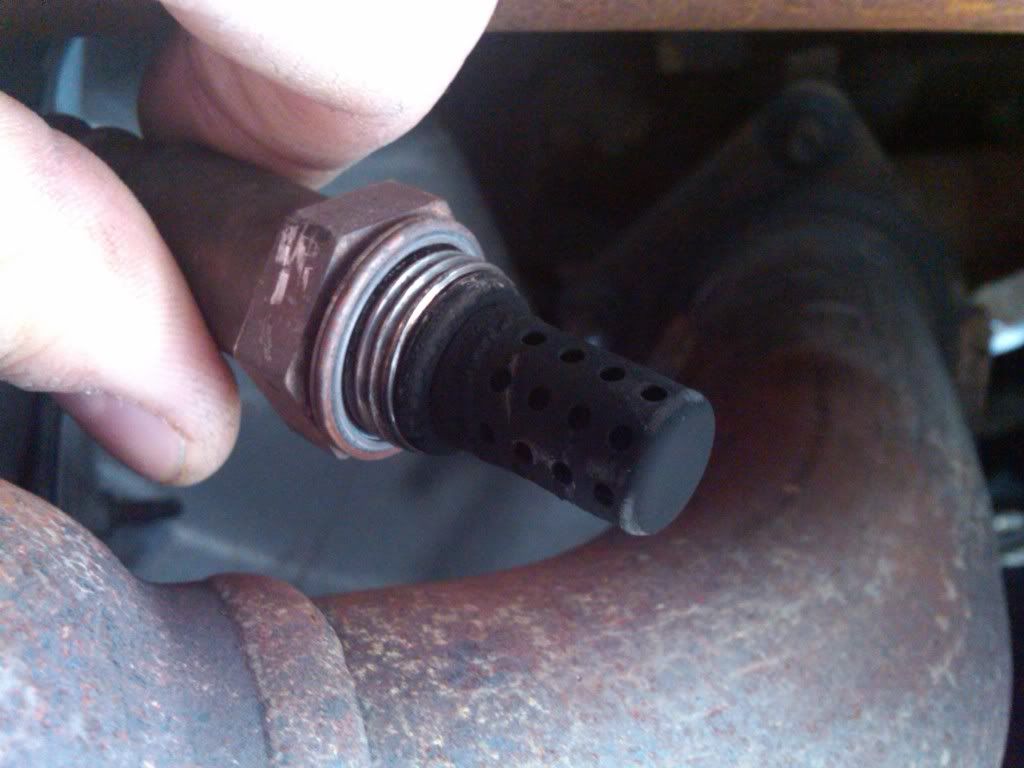

    Sounds like an o2 sensor crapped the bed.

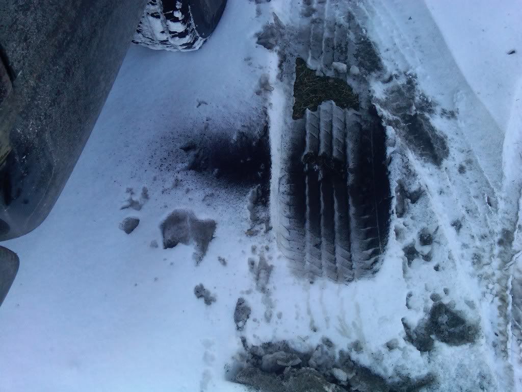

    Found a lose plug wire last night fixed it ans still smokes black under throttle. Codes are p0300 and p0131 pre plug change going again now to get them checked again.

    The paper I got said rich condition bank 1 then went on to say the the things it could be. If so it kinda makes sence when I pulled the driverside plugs they were all black and fouled. The pass sisde plugs had a nice light brown.

    well i got new plug wires plugs and replaced the driverside upstream 02 sensor! i dont have the new wires on yet but with just the new plugs and replacing the sensor it idles smoother than it ever has since ive owned it. gons try to put the plug wires on while im off work 2weeks for christmas. oh and to ensure i dont have any problems with my cats i just ordered some lts and ory.
    here are some pics of everything.
