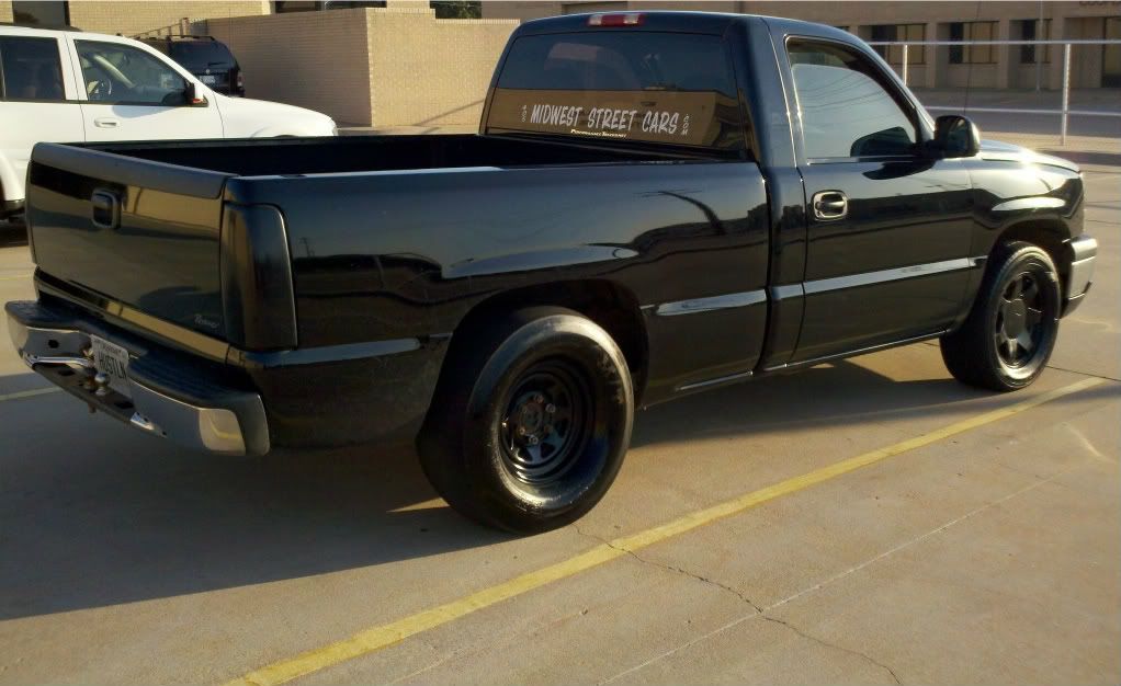

    Also got some new wheels and new slicks. Ordered some Bogarts but they weren't going to be here in time and I wanted to go racing at the El Reno Small Town Weekend deal. So I come up with these. M/T 29.5x10.5s-15 on Cragar wagon wheels that I painted black. They're not very wide wheels but I love that they don't stick out anymore.
