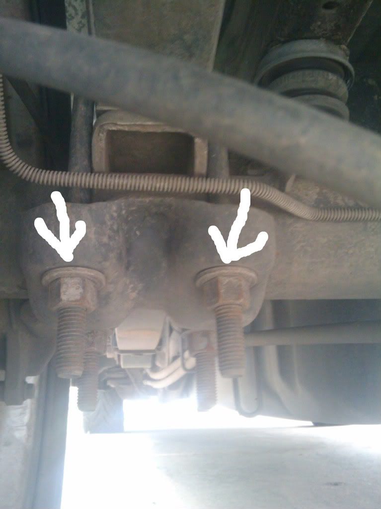

    Quote Originally Posted by zeake View Post
    A Pic would be great. Would washers work instead of new bolts?
    Thanks for all the replies.

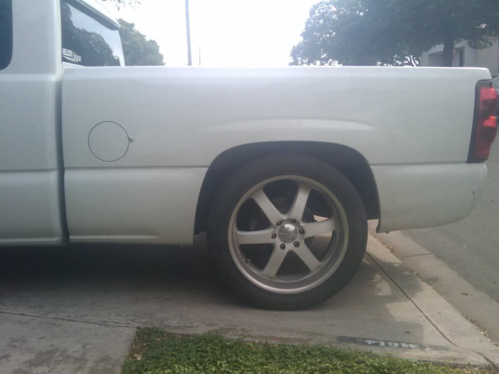

    here are the pics:
    the first pic that shows the white arrows, that has an extra washer on there. it now blends in with the factory washer thats on there lol
    the reason i used washers was cause when i tighten up the nut on the u-bolt, it had like 4 turns on the thread left before it would run out and not tighten anymore. so i used the washer like a spacer just have have a couple more turns on the thread.
    i did my friends truck and we did not need any washers on one side, the other side had more thread on it. it was weird but it still worked out ok.
    now this 2nd pic shows how my truck sits. i got a 2 in drop using shackles, plus what i got out of the leaf spring i took out.
    this other pic is not a close up but it shows how, there was more gap berfore.
