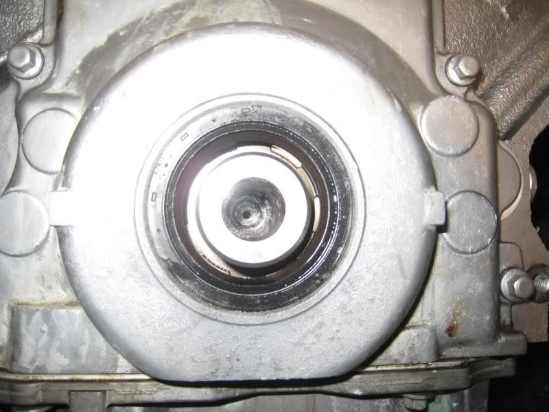

    I got the snapped crank bolt out
    I'm about to try this again. Just realized the harmonic balancer install tool won't work. I am going to try another technique

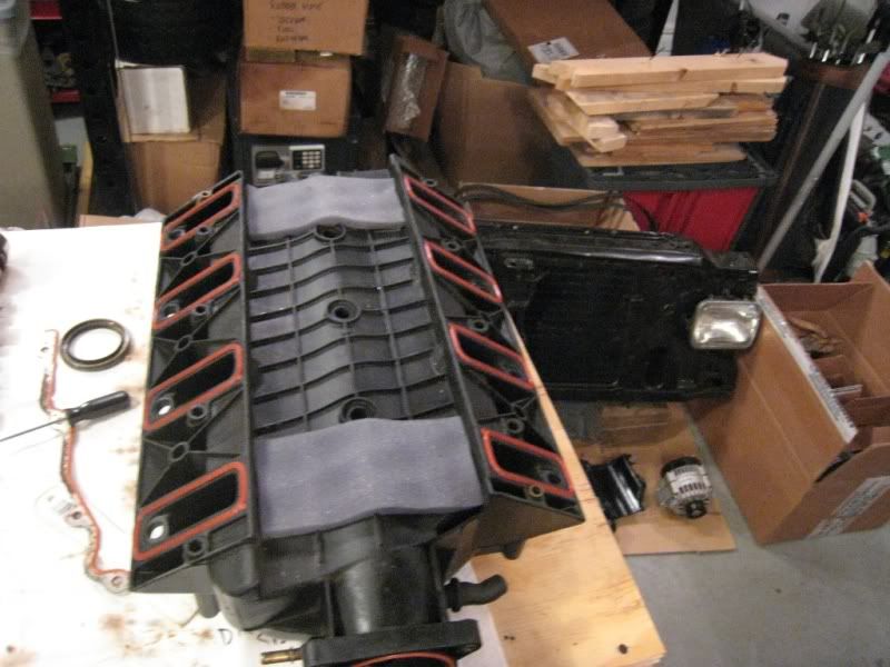

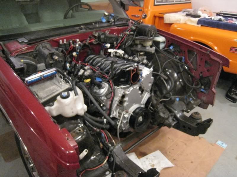

    I was able to get the snapped bolt out last night with minimal damage I was really worried about getting the center punch right in the middle. I took a 12mm deep well socket - 3/8" drive and slid it into the crankshaft. I then took my center punch and hammered it about 10 times to make a nice divot into the snapped off bolt. The 12mm socket fit perfectly in the crank shaft. I picked up some left hand drill bits and a new tap/die set with the 16mm x 2.0 pitch dies. I ended up drilling the small pilot hole, gradually getting bigger bits and testing the Easy Outs which didn't work and were too short due to the 3-3.5" of recess. I think I ended with a 1/2" drill bit and then the threads from the snapped bolt came right out. I rethreaded the crank shaft threads and now the new bolt goes in perfect. Torqued it to 37 ft lbs and 140 degrees.
    Pilot hole drilled
    New seals on the intake manifold
    Intake mocked up
