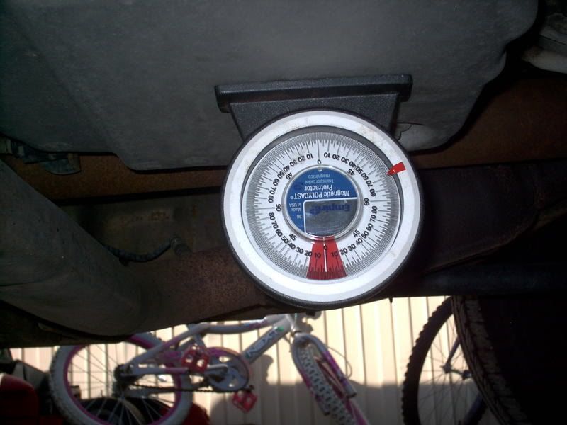

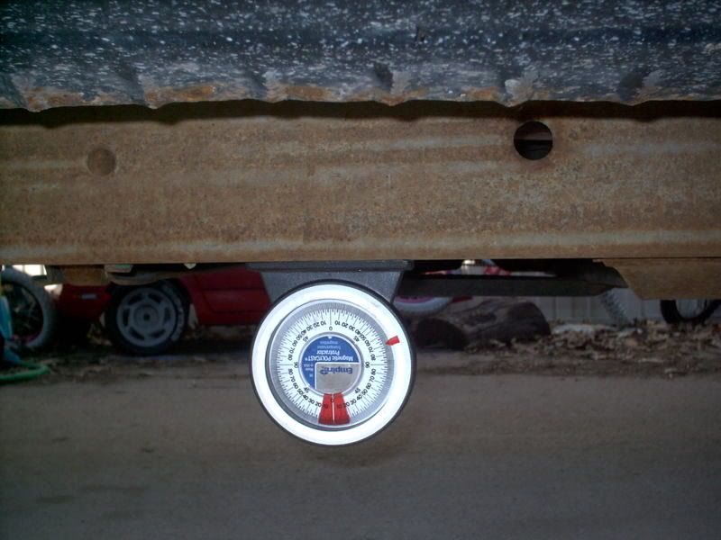

    Here's what I got hope it helps there both at zero or close to it. The first ones on the trans pan. The second is on the frame

    Excellent! Thanks for the info..............I was hoping it would be within 5 degrees.
