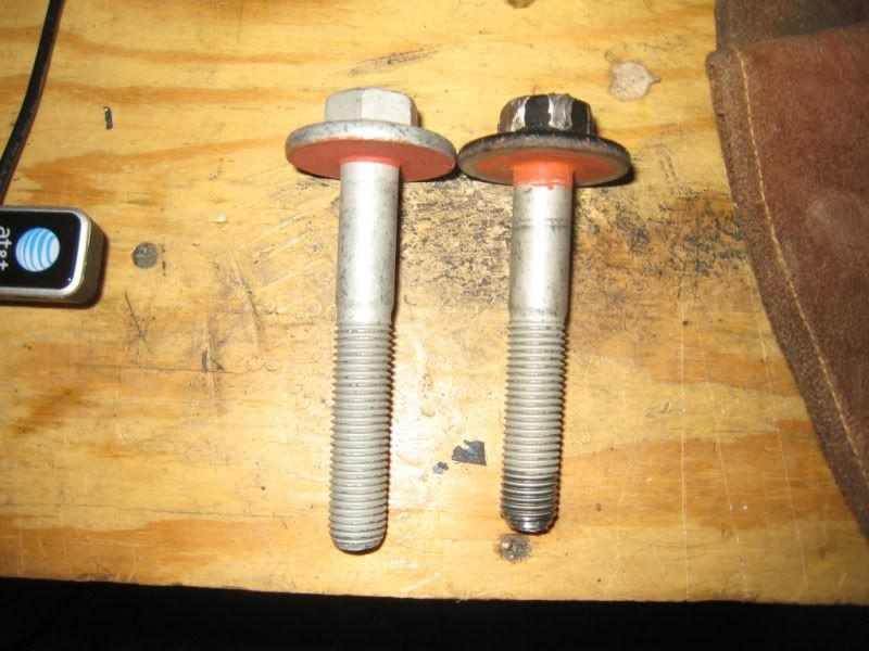

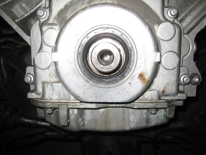

    Here are some awesome pics

    wow the head of that bolt looks really bad and that looks like its way up in there you may end up drillin that out just be cairfull and try not to mess your threads up that bad so you can chase them thru

    Those are TQ to yeild bolts so they stretch out of spec after one use. You do use one to seat the balancer AFTER it's installed all the way before putting in a new one. It probably did stretch too much using it as an installer. I would center punch it right in the middle as a starrting place for a small drill bit. Then move up a little at a time until you have roughly half of it drilled out. Then use and easy out (DO NOT BREAK THE EASY OUT). If it still won't come out, keep drilling bigger until you can use a pick to walk the broken peice out. A metric tap that size might be hard to find.

    Quote Originally Posted by GasGuzzler View Post
    Thanks for the info. I am going to try this method tonight. I'm going to see if I can find some left wound drill bits and a good set of easy outs. I need to see if I can find a thread chaser or tap/die set that will fit 16mm x 2.0 pitch. Worst case scenario - pull the engine and turn the 3 day project into a 3 week project.

    I agree, I would just go straight to the drilling out method, center punch the center, start small and work your way up, and use a pick to back the threads out. Might take a few minutes longer, but you don't have to worry about trying to get a broken easyout removed too. Good luck
