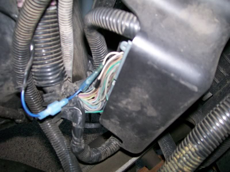

    I'm assuming it's the green one on this plug...
    I'd rather not tap off anywhere NEAR the PCM lol

    Ummm...white wire pin 10 on the red connector

    Quote Originally Posted by oleshifty View Post
    Doesn't really matter if it's near the pcm or not, it all leads back there...
    Quote Originally Posted by danger_ranger83 View Post
    Depends on which pcm you have. mine has a blue and a green connecter

    Quote Originally Posted by parker View Post
    Well his truck is an 01 so it has the red and blue
