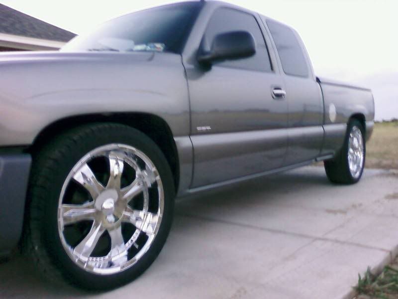

    2006 GMC Extended Cab. This truck
    Has a shaved tailgate and roll pan also. I can't find anypics of that.
