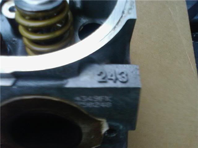

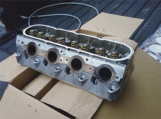

  10. #60
    Oct 2009
    Seattle, WA
    255
    Pictures!
    Got some pictures of the heads. Will get some pics of the block after I get in all cleaned up.
