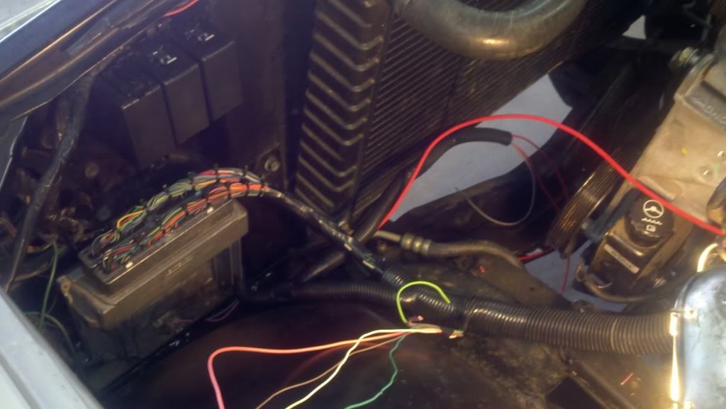

    I am finishing this one now. Its a 72 K10 04 5.3 converted to DBC. This one is super super low budget. Owned by a 17 year old that is starting his senior year in two weeks. Fired it up last night so it should be ready by then. Sorry the pics are all out of order. It came to me with the engine already installed. I had to mount the pcm, fuse and relay center, mount wire and plumb the fuel system, mandrel bent Tig welded exhaust, wire and plumb the guages, etc...

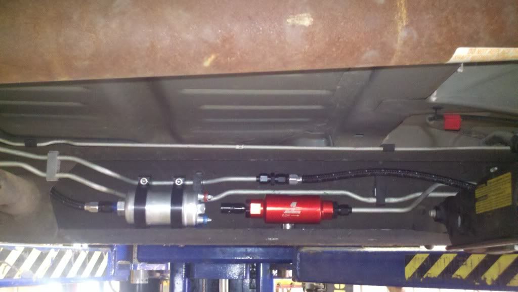

    This is a fuel system I built on an 06 Sierra turbo 370 truck. Aeromotive 340 intank thru a Bosch 044 inline. Converted to return style with a boost referenced regulator. The Bosch is energized via Hobbs switch and both pump s on Racetronix relay kit. Having issues with it even though its pretty.
