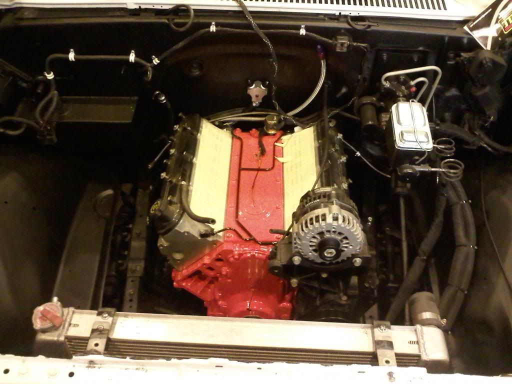

    Hydroboost Setup and my current progress
    Here is what i went off of to do my hydroboost setup
    parts list
    1 12 x 12 plate which needed cut to make hydro unit mounting plate and a hole cut in the center
    1 4ft 3/8 rubber ps hose
    1 hydro ps pump from a 2001 chevy 1500hd
    1 hydro brake unit from 1986 1 ton
    1 hydro master cyl from 1986 1 ton
    1 hydro boost lines from a 1986 chevy 1 ton (to the steering box) fits perfect
    1 hydroboost line from a 2001 chevy 1500hd (to the pump) needs tweeked!!
    brake lines - stock
    brake pedal - stock
    Here is what i got done in the last few weeks ..... waiting of powdercoating and milling of the turbo headers ...
