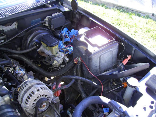

    I took the underhood junction box from the 2001 and have it on my fenderwell.

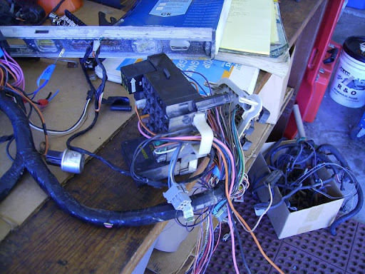

    The 91 "convenience center" is right behind the C100 connector under the dash.

    My 1991 "Convenience Center -- a.k.a. CC:"
    2001 Suburban "Underhood Junction Block -- a.k.a. UJB:"(the part with sun reflection on it)
    From what I can tell, the "UJB" will replace the "CC" distribute power among the main circuits, and then the blue taped wires just on the engine side of the firewall will go thru C100 hole and just solder into the instrument panel, steering wheel/turn signal/ignition switch/etc. Then I will do away with the knee-high fusebox from 91 and use the drivers side of the dash fuse panel from the 95 dash. My intention is to keep ALL 2001 fuses/circuits intact from under the hood..PS which years did NOT have an airbag??
