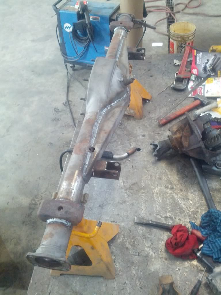

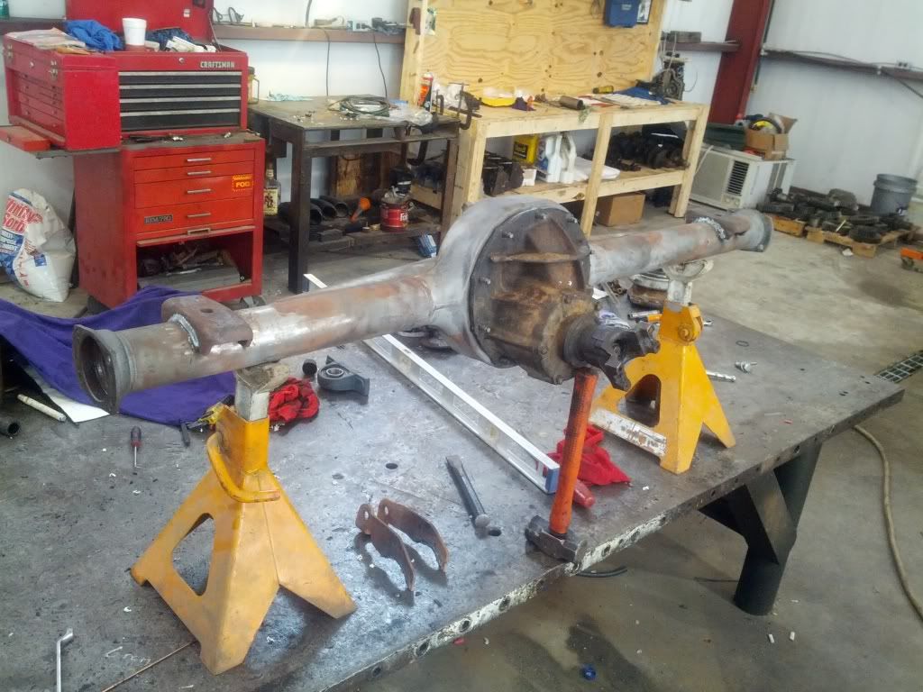

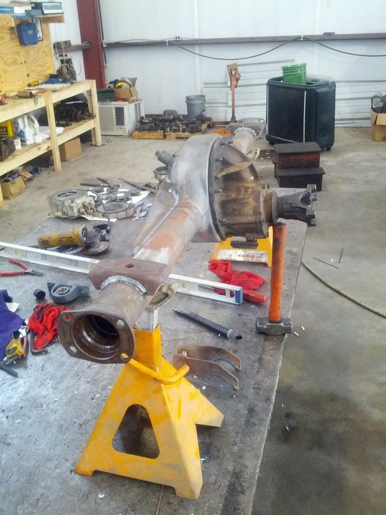

    Next I set up the dial indicator on the back of the housing and pre arched the housing 1/8 of an inch to compensate for the weld distorting it. after I got everything welded up it still pulled the housing a little. you can see howuch it pulled from this point I took my bottle jack and dial indicator and straightened it back out. Hard to really tell from the pics though. . I have the spring pads and shock mounts that I cut off one of the many 10 bolts I've destroyed that will be going on next. I'm gonna tack them on when I get the rear under the truck so that I can get my pinion angle right. The 9 will be equipped with a spool, 373's , and strange axles and 3rd member. I ordered my heim joints to build my own cal tracks per 02camaross's wright up. http://www.ls1truck.com/forums/power...tion-bars.html . Next is an all new hot side piping. I absolutely hate the looks of the flipped manifolds and will be using a modified set of shorty headers to build something similar to the trick performance log manifold. Stay tuned ........

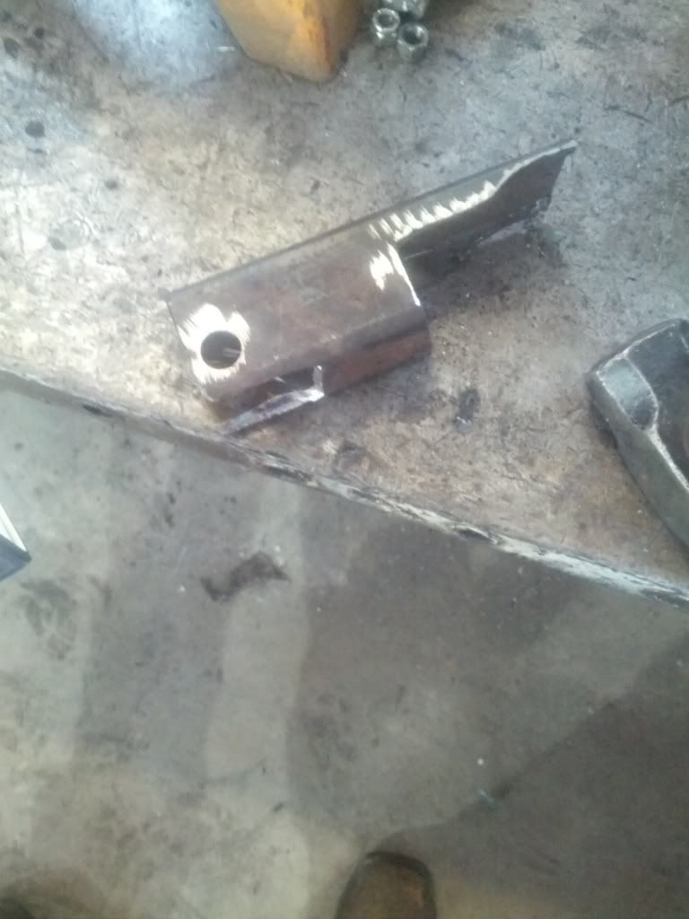

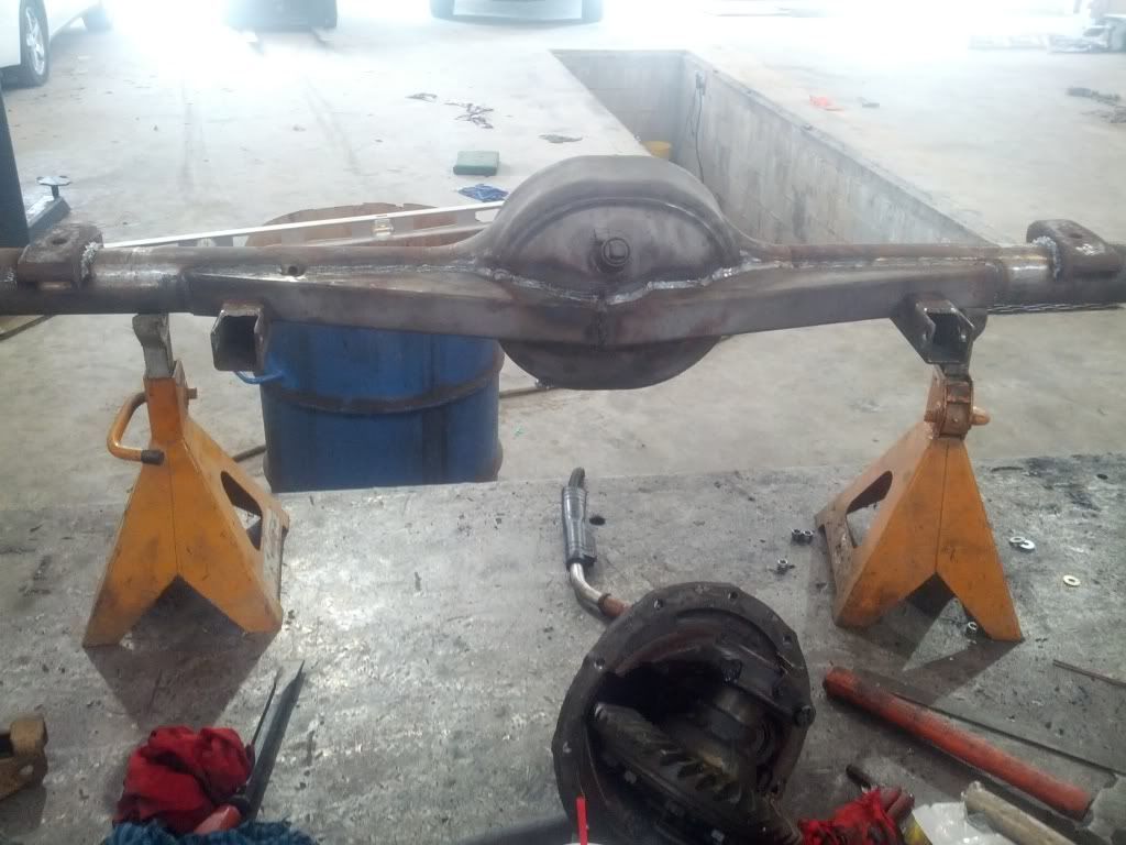

    Been a while since I've worked on my 9" . I'm trying to buy a house and build a shop of my own to work out of so progress has been slow. I got my spring pads welded on and my shock mounts fabbed up and tacked into place. After talking to a few suspension guys I decided to mount both shocks to the back of the housing.all I need now is a set of 33 or 35 spline axles and a spool to finish this thing up. Hope to have it painted tomorrow. The back brace was a little aggravating to work around when I was fabbing the shock mounts but this is what I came up with. What do you guys think?
