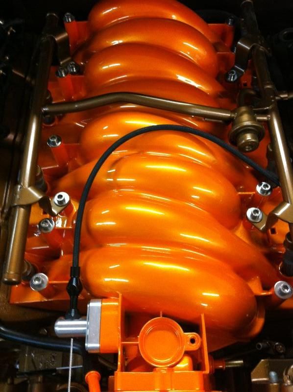

    oh and i had to cut off the cruise bracket, which was ok cuz i deleted cruise control. dented in the h20 neck, trimmed the edge of cable guide and the truck TB fits with no rubbing.

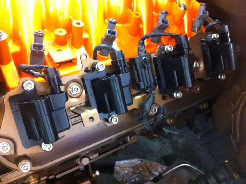

    all SS allen bolts
    what a B*@#h these are with a bodydrop! Drivers side 5min, pass side took 3 hours LOL
    Lokar cable and single mount bracket that will be painted orange. Very nice and easy to install.

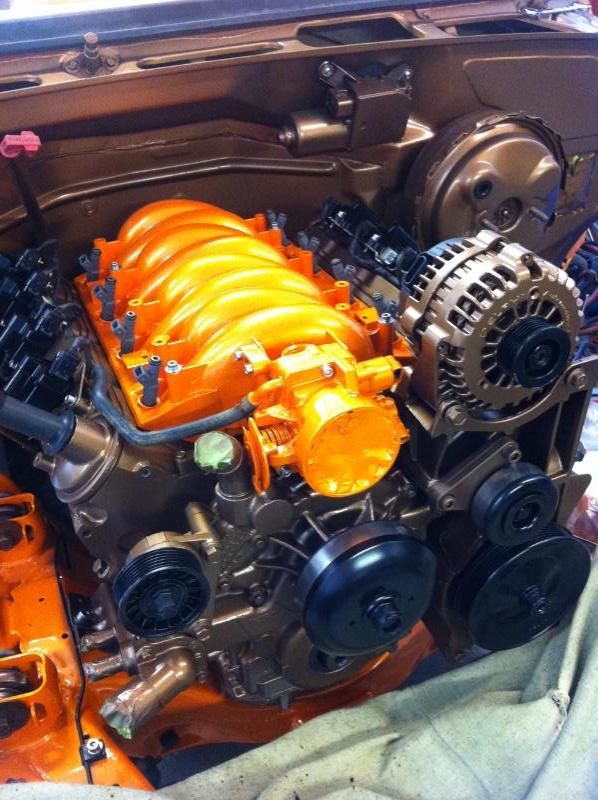

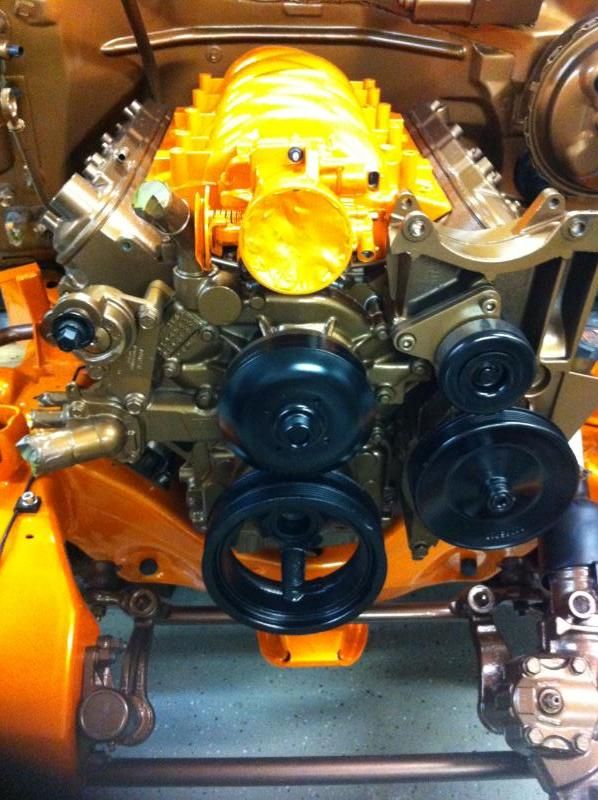

    Now the fun has begun. JK i hate this part
    started with this..
    down to this..
    Im sure nothing will work!!

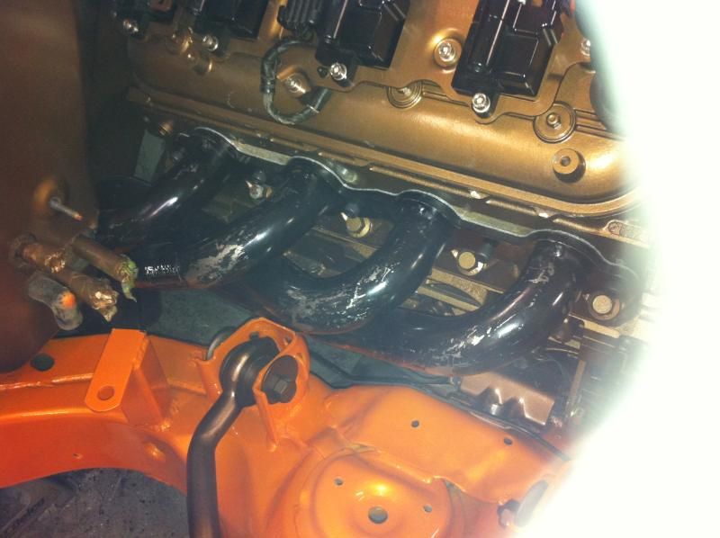

    Were did all the paint on the header go lol.

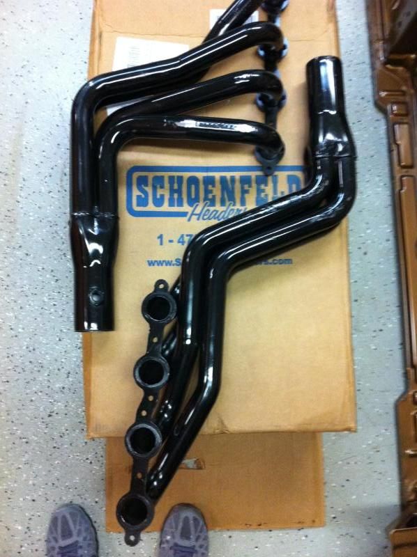

    Are you going to have a problem with the headers hitting the ground when layed out. Does your truck have a traditional BD or stock floor BD. Im bagging and bodydropping my dually with a 6.0 and want to be sure im not going to crush the headers when layed out

    I have a 3in stock floor. No they stay above the bottom of the frame. Its the pass side that is the problem with the hearder hitting the firewall. I had to beat it in a little to clear. its also very tight with the floor at the end of the header.
