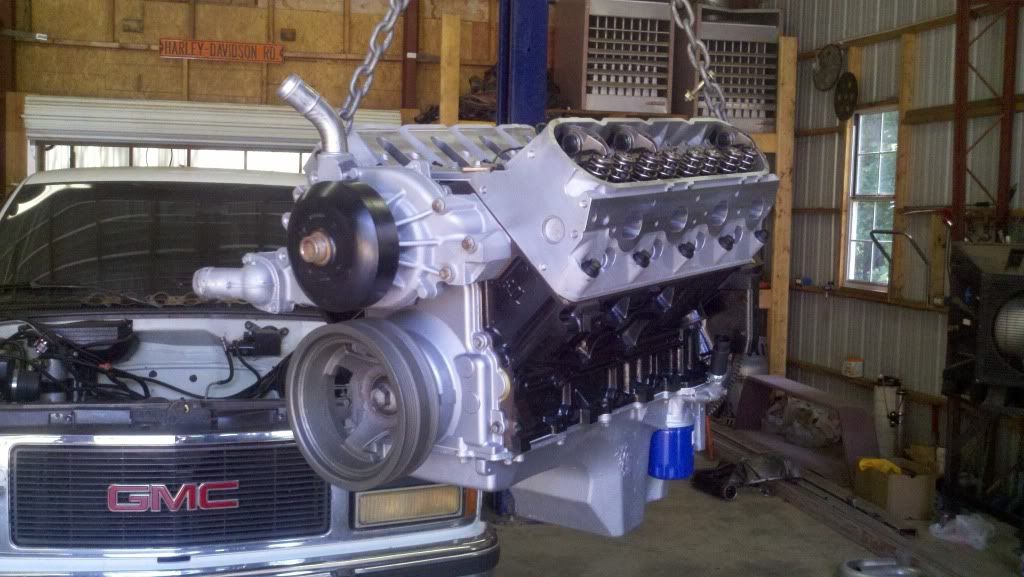

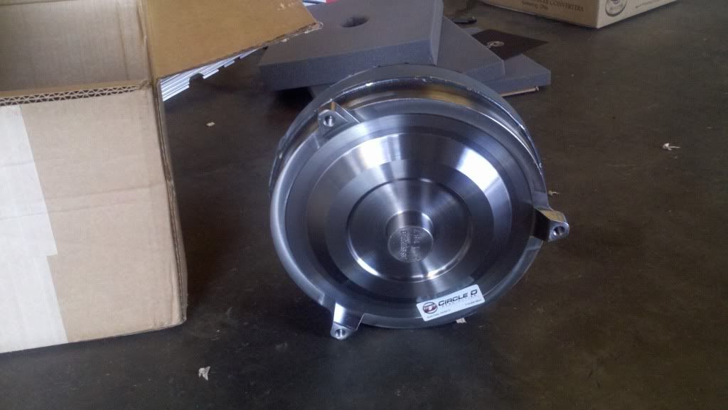

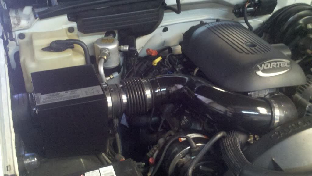

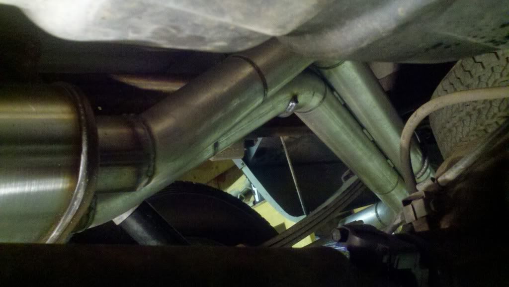

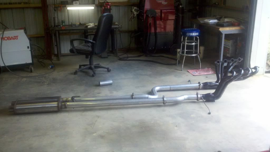

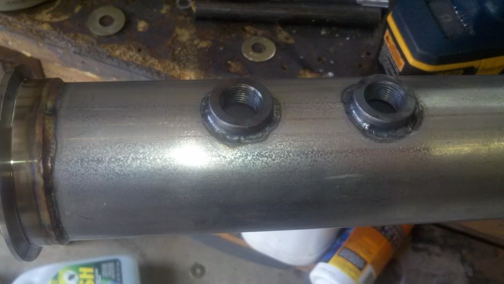

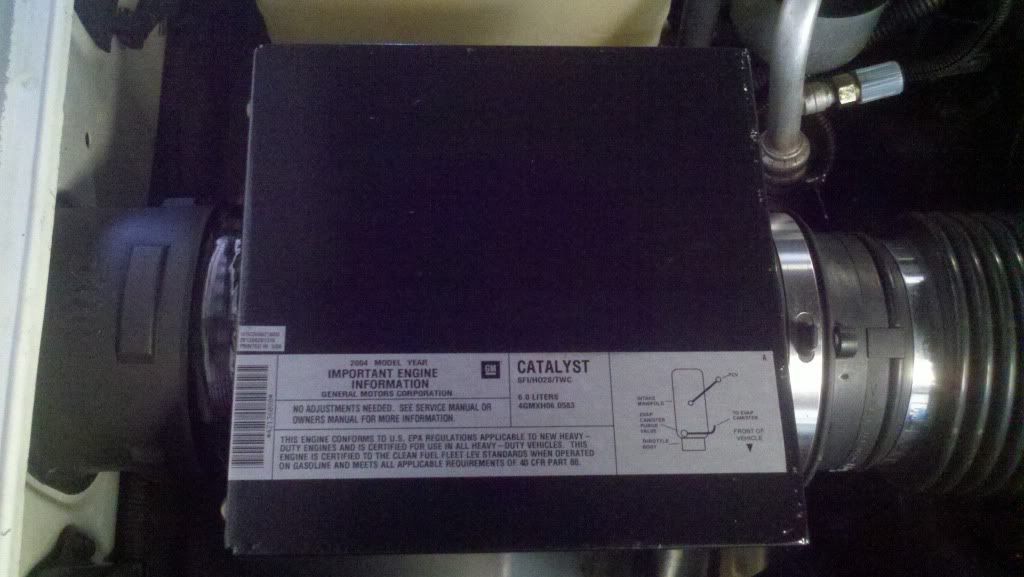

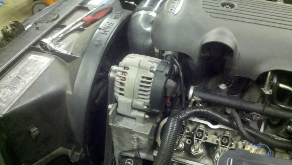

    Almost finished with this truck. Dyno tune is Wednesday. Only thing after that is to send the Shoenfelds for ceramic coating. Ended up doing a 3k Circle D, two speed ls1 fans, and a cable shifter conversion because of interference with the long tubes. To finish it off, I ordered a Catalyst label from GM for the VIN of the donor truck. Hopefully 92Siearra doesn't see this bc the label is a surprise. Lol. Here ya go!

    Dyno tune is done. 356hp/358ft#. Im taking the headers to be ceramic coated in black to match the intake tube and box. Should look sweet. Another oil change and the Sierra is going home nearly 4 months later. Lol
