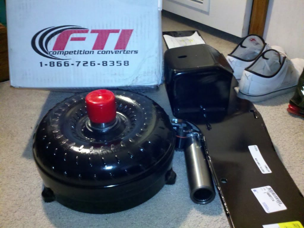

    While it was apart, I ordered a new converter suited for my combo, ordered a roll pan, some bogarts for the rear and some bigger stickies. I've had the parts to lower it for some time, just haven't had time to make it happen. Once its lowered we'll have to redo the traction bars so that's another reason I've kind of been dragging my feet.

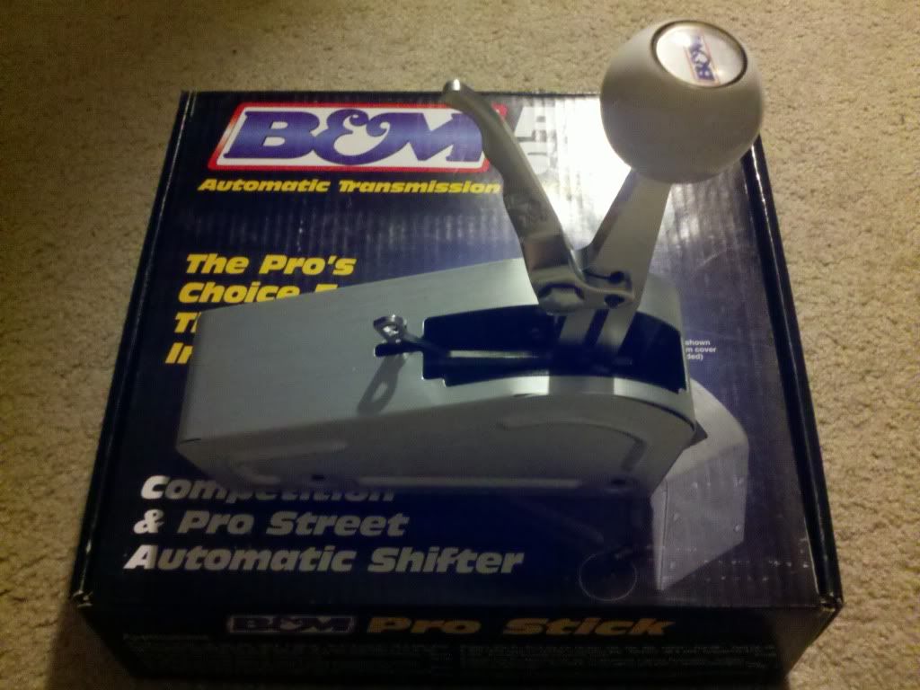

    Been collecting parts for the past couple weeks for my next project. Found a smokin deal on a 4L80 and I couldn't pass it up.
    (The racepak is a requirement for this kind of swap right? lol)
    Got the shifter mounted up this last weekend
