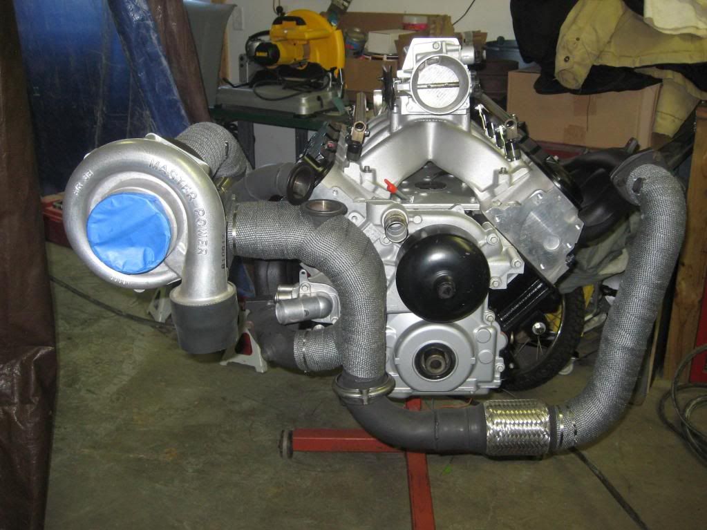

Check out some of my pictures, I have one of Allens flipped manifold kits. Works great and no issues. This is one of his newer kits, and he has since modified his design to better accommodated space in the engine compartment.

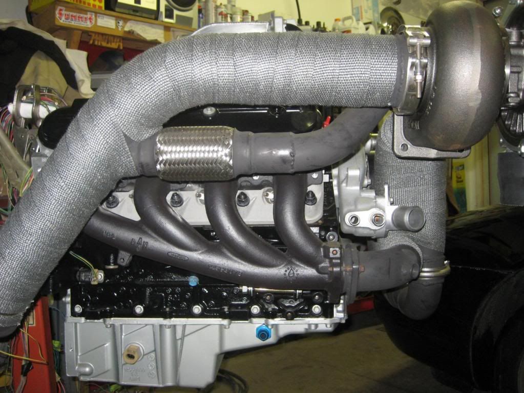

a couple of log pics. the driver's side crosses over the front, and Y's into the T4 flange.

found some more.

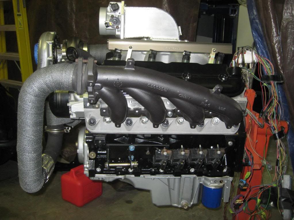

Here's some more pics of a log design, less complete so you can more detail.

use 2.5" on the crossover and a min of 3" on the log. Use 2.5" from the manifolds to the turbos.
hope this helps.

thanks so much guys for the pictures and the help. Im thinking Im going to go with the traditional log route with a factory manifold on the driver side crossing over underneath the truck then build a log with a 90 degree angle to the flange. Where can i get sch 10 3" 90 degree bends from? And at the back of the log where the crossover comes in, should I Start the log at 2.5" then buy a 3"-2.5" reducer or do i do 3'' the whole way and weld a vband flange on it and have a 3"-2.5" reducer on the crossover right before it goes into the log?

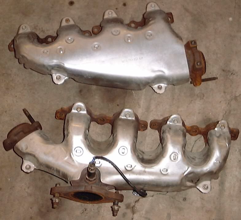

So I did a little digging and found these pictures on ls1tech. This guy used two of the same manifolds from a LS4 car. The manifold used is the one closest to the front of the LS4 cars. I do not have my truck in front of me right now and wont until mid next week. At that time i plan to pull the headers off and mount my factory manifolds and see how hard it will be to make some hot pipes. I will do the same with my LS3 manifolds of off my camaro. If neither of them seem to be a good fit, I may buy some of the LS4 manifolds because they seem to be right on. The only thing Im a little worried about is that the LS4 manifold has only a 2 bolt flange. Tell me what yall think!
