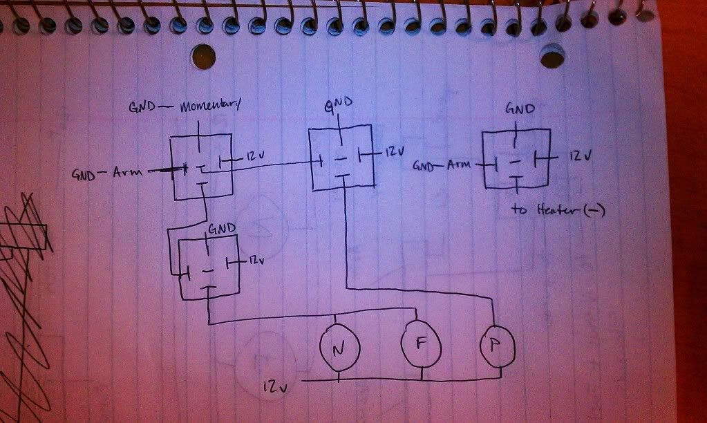

    Okay so basically this is what I came up with. Anyone see an issue?

    That diagram/schematic isn't right.
    The way it is now, the relays won't even click/engage.
    The coil winding or device that gets energized is on pins 85/86, they do not have polarity btw.
    The load and main power supplied to the load is switch on and off between pins 87/30.
    Follow this.
    Pins 85/86 can be small gauge wire (18g), and are usually tied into ignition or battery (this one shows batt).
    Pins 87/30 are typically 14/12g, depending on load.

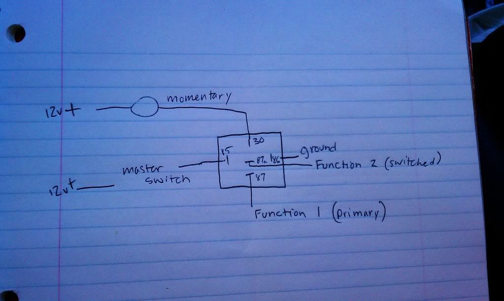

    I know what you want but I'm not infront of a computer at the moment. I'll draw it up and send a picture.

    Pin 87 and 87a need to be switched on my diagram.87a is the normally closed position.
    See that's the same as mine.

    This should do what you want.
