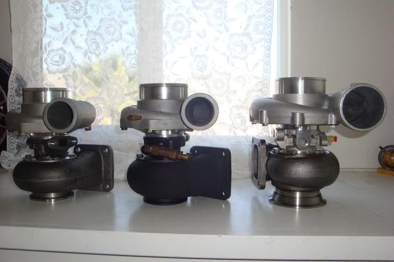

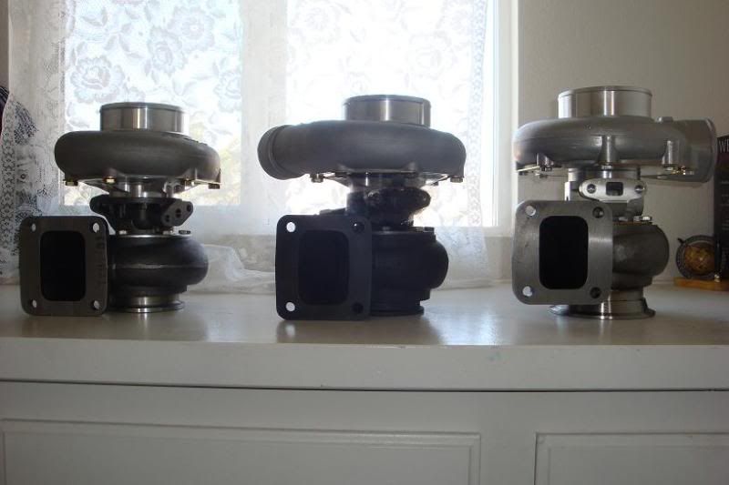

    Here are some pics of the GT-76 I have for the Silverado and the GT-76 I took of the Hemi(Black coated turbine housing - Left).
    I had to replace the turbo in the Hemi so I got a Comp 80/79(Right).
