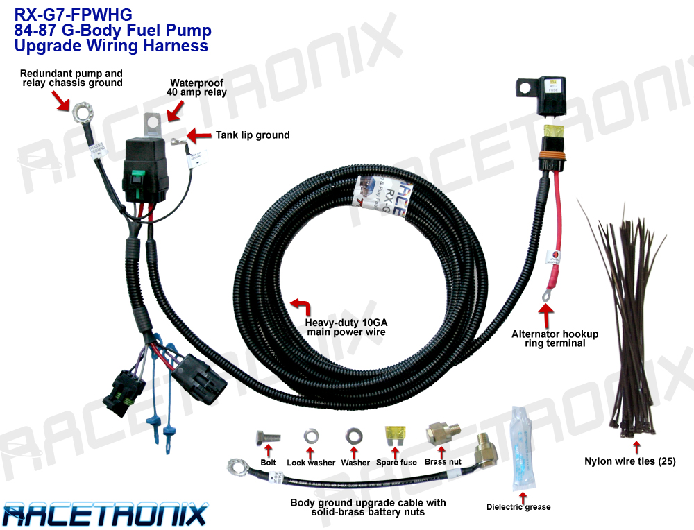

    You're about where I was at with your fuel issue. I tried Greg's suggestion and ran the hotwire kit to get more voltage to the pump and my fuel issue is no longer an issue. Still need to check it with HPTuners, but my A/F is perfect at all times now all the way up to 12psi. Might be an easier fix for you to run the Walbro with the hotwire kit...? I know I'm not telling you anything you don't know but it beats buying two pumps and wiring and all.

    Beats running two pumps or doing the Hobbs switch and all of that. Racetronix sells a nice harness for around $45. It includes a heavy duty relay, heavy wire, etc. Needs a little modifying, but makes it pretty easy.
    We have similar setups - if it works for mine, it should work for yours I would think.
