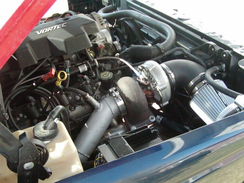

    Well Quik, you called it, the engine is a 2000 model Tahoe 5.3L. I finally hooked the PCM up to HPTuners and verified the VIN.
    The turbo stuff is all done except for the cold side plumbing to and from the intercooler. Added an Autometer fuel pressure gauge under the hood just because we had it. Fuel system is complete minus a 6' long -8 hose I'm waiting on. Ordered new Camaro 02 sensors to work with the 2002 Camaro tune we're using. Also waiting on a 4" x 90 degree silicone elbow from the turbo to the filter, this is necessary since the radiator and electric fans are now in the way.

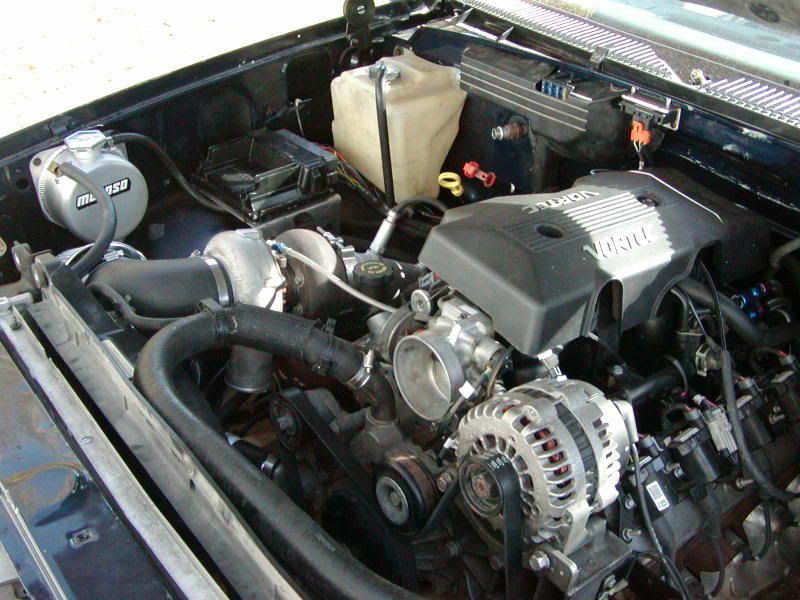

    Here's where we sit today. Not much work going to be done this weekend on it since NASCAR is in town.
