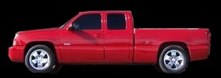

A big thanks to Geg(redheartbeat) and Jason(ghost04) for all the help.
Workin a little friday and a lot satuday it took us a little under 12 hours to go from an 06 4.8 to an 05 LQ9. It stll doesn't have tune and is running off the 4.8 pcm because of a pcm issue with the mail tune. But it feels really strong with the 4.8 pcm. Can't wait till he gets a real tune. It went really smooth untill the startup, we had a problem with the starter and 2 of the injectors were clogges but thanks to Gregs fast thinking we got it taken care of. I learned a lot in the swap and got really involved with the coaching by Greg. Thanks again Greg and it was good seeing you again.
