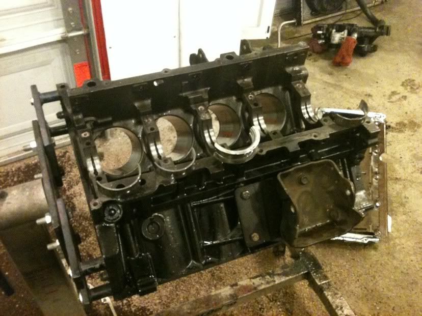

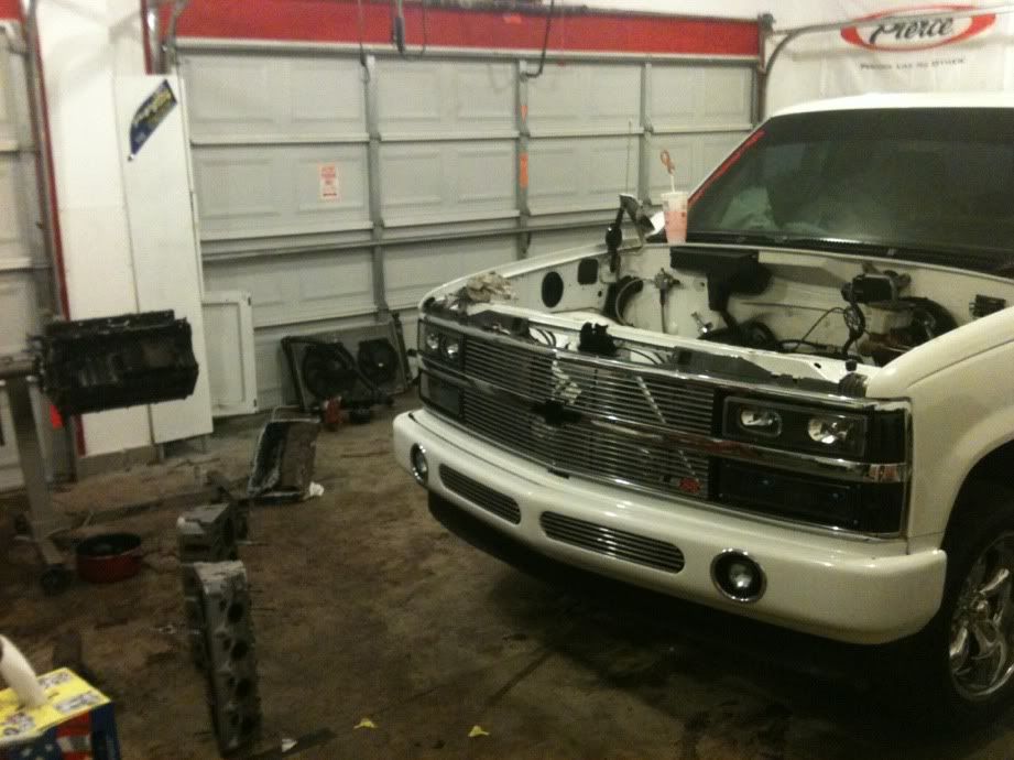

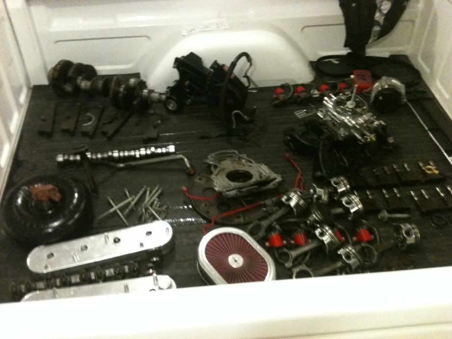

Last summer I took my truck out for a cruise and it bogged and locked up tight on me. come to find out the oil pump went out and i lost oil pressure. so i put it in storage and forgot about it till this past weekend i finally got the motivation to work on it again. so i pushed it on the trailer and brought it home. A buddy and i pulled the motor and tore it apart to the bare block to check out the damage. I think i got lucky only the main and rod bearings got chewed up. none of the bearings spun, everything from the cam up doesnt show a bit of damage anywhere still looks like brand new. all the cylinders still look brand new with all the cross hatching still very visible.
The block and the crank are getting dropped off at the machine shop on thursday. the block is getting boiled and all the oil gallies cleaned and the crank is getting grinded and polished.
