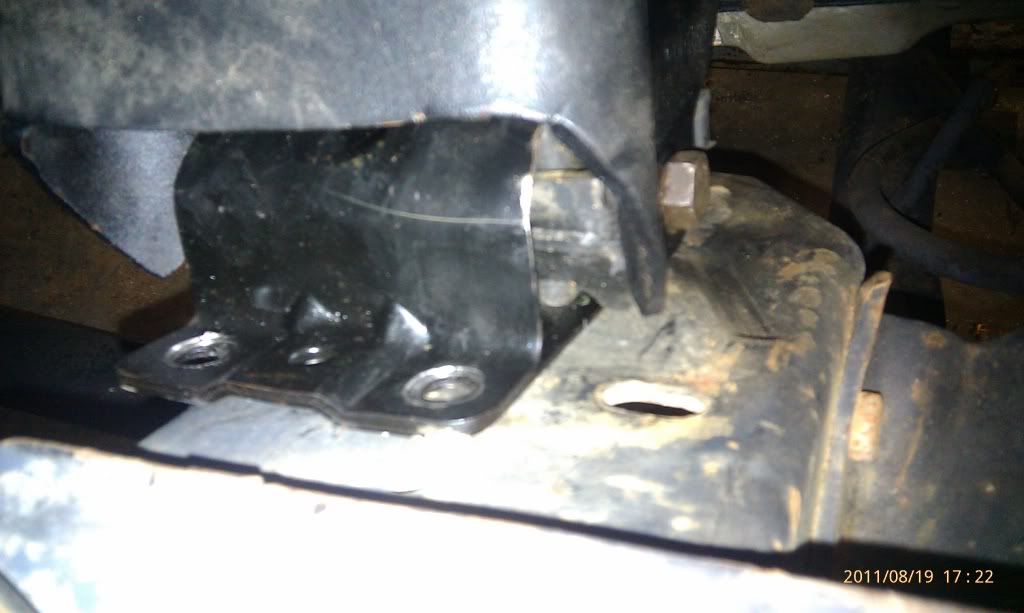

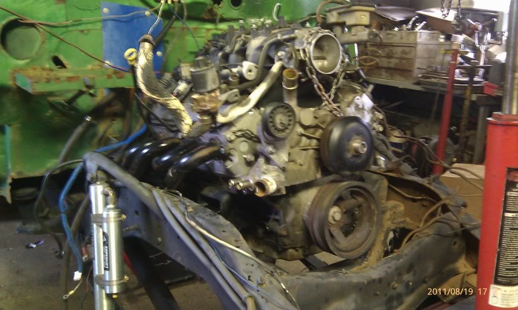

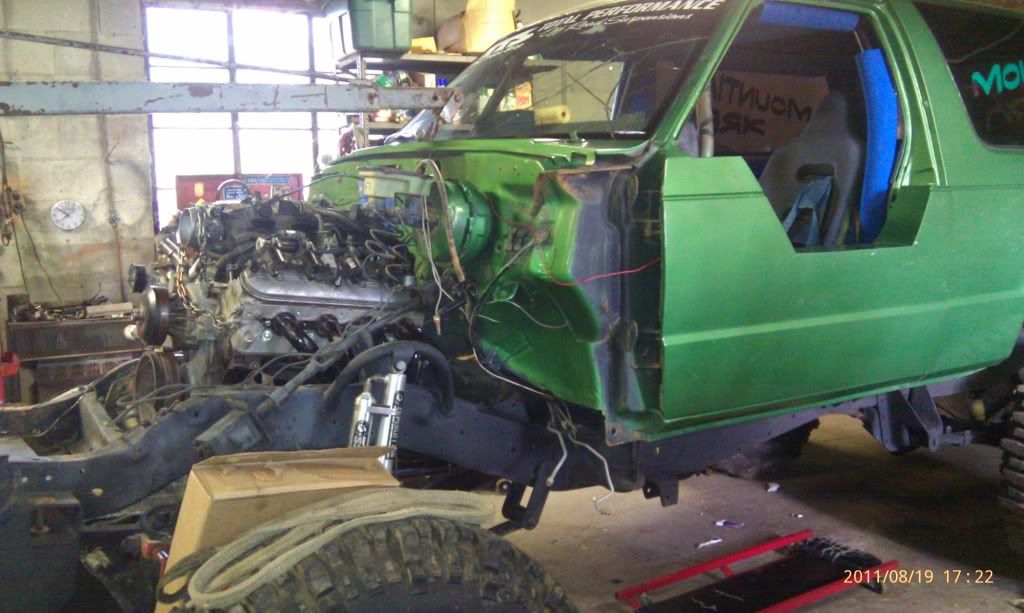

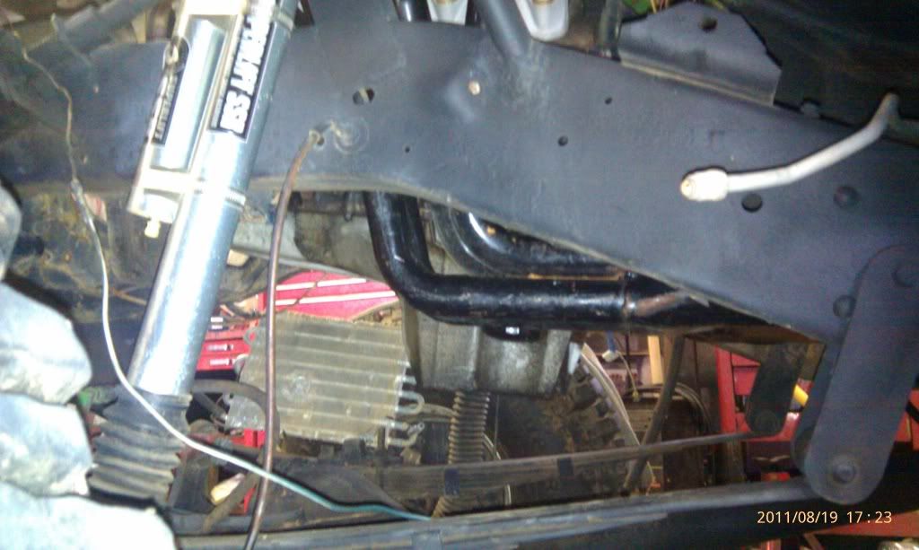

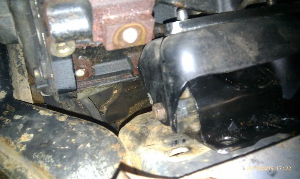

    Got the 5.3 in but have some problems with alignment.
    Driver's side:
    Passenger's side:
    I think that I'm gonna unbolt the frame mounts, modify where needed and bolt/weld them back in place. Or maybe fab some up.
