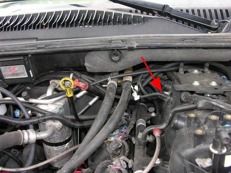

there is a nipple in the back pass side of the intake that you can break the end off of and use.

<div class='quotetop'>QUOTE(BEATERTRUCK @ Jun 30 2007, 04:14 PM) [snapback]98211[/snapback]</div>yup... Just break the tab off, and connect the hose.there is a nipple in the back pass side of the intake that you can break the end off of and use.

<div class='quotetop'>QUOTE(91_bowtie @ Jun 30 2007, 05:27 PM) [snapback]98213[/snapback]</div>thats the vaccuum im using is but im feeding meth ,boostgauge,and bypass for s/c is that ok or is there onother vaccuum im not aware of i can feed off ,?anywere on the motor im not comfortable feeding all 3 on 1 vac,.yup... Just break the tab off, and connect the hose.

<div class='quotetop'>QUOTE(ramsey rider @ Jun 30 2007, 07:31 PM) [snapback]98221[/snapback]</div>thats the vaccuum im using is but im feeding meth ,boostgauge,and bypass for s/c is that ok or is there onother vaccuum im not aware of i can feed off ,?anywere on the motor im not comfortable feeding all 3 on 1 vac,.

If you follow the line that I have hooked up there, you'll see that it's tied into my meth system, and whipple bypass too. The only issue I had in a year of daily driving was that I had to wrap the plastic line going to the gauge connection with electrical tape to keep it plugged in the T-fitting. I think you'll be fine.![]()
