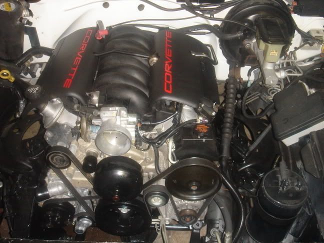

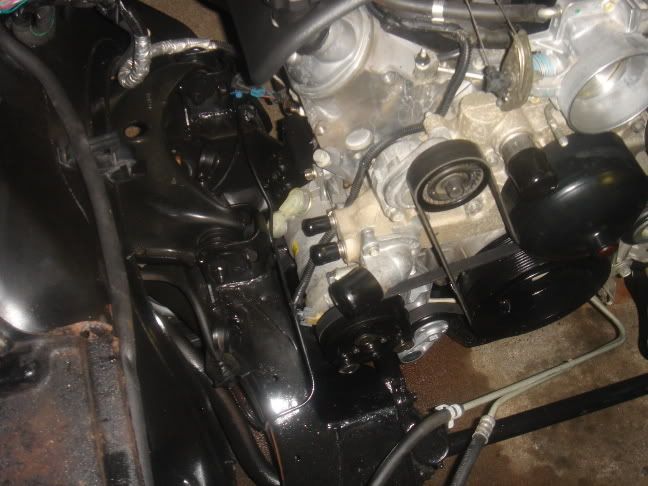

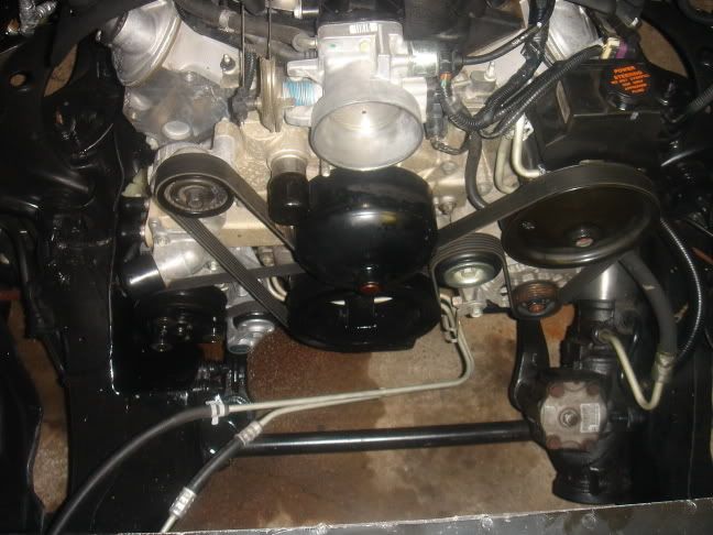

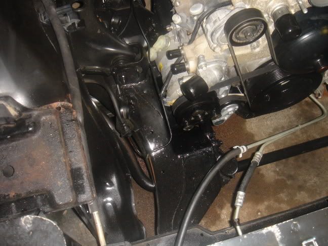

    Starting to come together. The drive train is back and the tranny linklage together. I really posted this to show off the truckk A/C compressor with the LS1 accessories. The clutch switch cleared the frame with no problems. The covers work well with the new throttle cable bracket also. Can you guys believe the front end is on this baby! I can't believe all the room between the radiator and the engine! BTW, that ugly battery tray is fixing to be gone!

    Looking great, Lance. Can't wait to hear it running.
    What were you doing for a radiator and electric fans? Fbody or 2005+ Silverado fans? If you do the Silverado fans keep me informed on how you mount the upper flange to the core support.

    that looks sweet, love those corvette covers!

    Thanks again guys! Greg, I'm using the F-body fans since they came with the engine. If there's a cooling issue which I don't think there will be, I'll get some truck fans.
