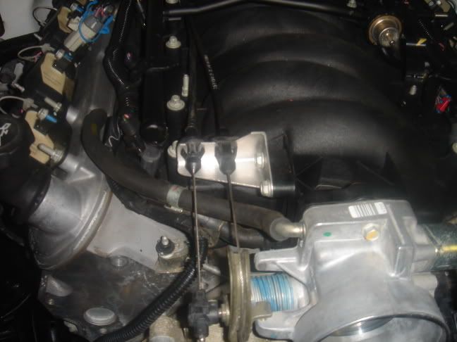

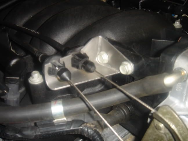

    I made this today out of stainless and gave it a satin finish. It lowers the throttle cable down an inch and keeps you from having to cut the hell out of the front of your fuel rail/coil covers. It also maintains the stock 96-98 truck throttle and cruise control cables. I had to finish installing my driveshaft so I didn't have time to fit the fuel covers. I'll post pics once I have them on. With the new drop on the front of the truck it threw my pinion angle off about 4 degrees. I've got to finish lowering the rear now and that will have me at 6 degrees. Looks like I have some shimming to go.

    Very nice! Wanna sell your stock throttle bracket?

    good work..... looks like a stock piece.

    Not just yet, I&#39;m still testing with it. If I come across another I&#39;ll hollar at you.

    Thanks&#33; I&#39;m just playing.
