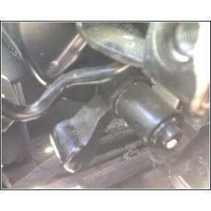

    Power steering is connected as follows, ps pump to cooler and out of cooler into steering column, out of steering column into reservoir up by brake system, out of reservoir back into pump. There is a threaded connection for ?? that dumps power steering fluid when I run it. Are the lines routed differently on the stock 2001 ps pump from the '94 setup, or am I missing a threaded line?

    High pressure side of the ps pump goes to the ps box and then out to the cooler before returning to the pump. The last place the fluid goes is to the cooler.

    It is the connection that runs off the pump, I'm just going to block it off.

    are you refering to a hydroboost PS pump? you can block off the hydroboost port.

    Thats what it is, nice I'll just block it, happen to know the size plug it takes?
    I don't know for sure but my guess is around 5/16- 3/8
