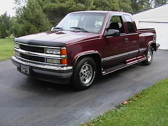

    I have been researching for a couple years and am moving forward with the project as my transmission went out in the truck.
    My current plan...please critique or fill in voids...

    Lots of views but no responses? Hopefully that means I'm on the right path. I'll try to keep updating this as I move forward as others may run into similar problems or questions....
    I pulled the TB motor out and dropped the LSdrivetrain in.
    I have ordered many parts....
    I am using 99 truck radiator hoses
    I'll try to update when parts work/don't
    I bought the Corvette style filter and some adapter fittings but do not need them. I have a dual line engine
    It looks like I will need to drill new holes in the frame for the trans crossmember. The mount on the 4l80e is 5-7 inches further back than the 4l60e.
