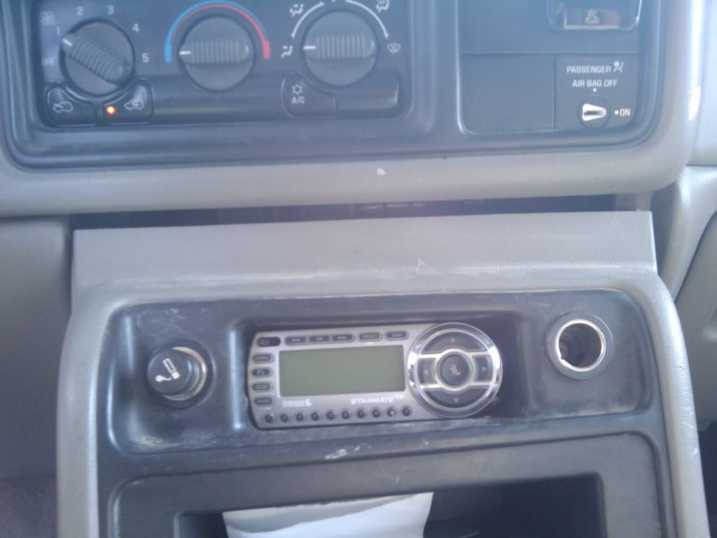

    i have the center console of a 04' suburban, i had to change out the glove box and the lower knee booster. The only other thing was re-plug in the power for the cig. lighter and that was about it, i kept my 00 dash bezel i did not get that cause i did not know about the gap that is left but its not much. Ill post a pic of it in the morning, im at my ranch and dont have my camera with me just my cell which has no flash

    the harness plugged right in for me as for gap its almost .5 inch thats noticable to me

    where is the gap? and thank Ya'll

    more than likely along the bottom of the dash bezel, since everything else is pretty much the same.

    here is the pic of the gap, it was a lil over a 1/4 in. sorry for the poor pic it from my phone and, yeah i know the truck its a mess im living at the ranch since i got laid off.
