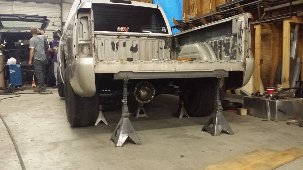

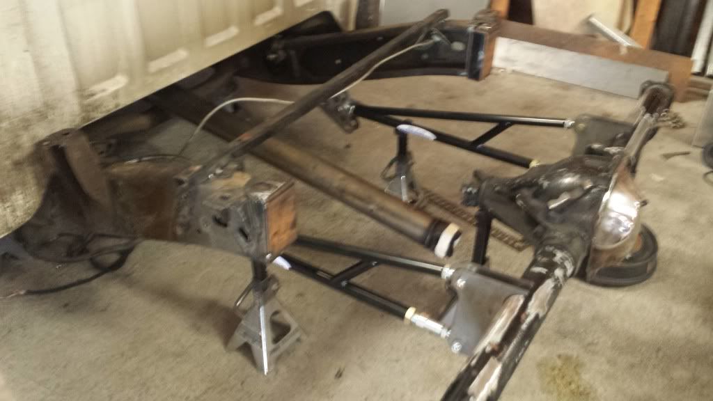

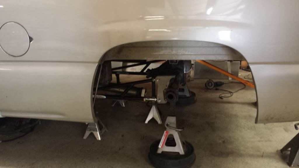

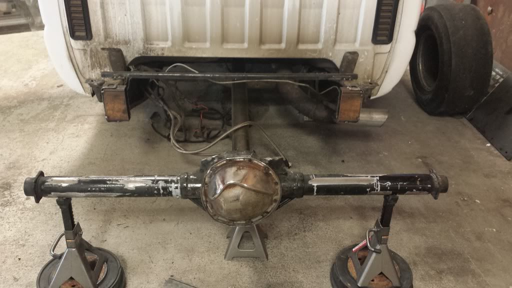

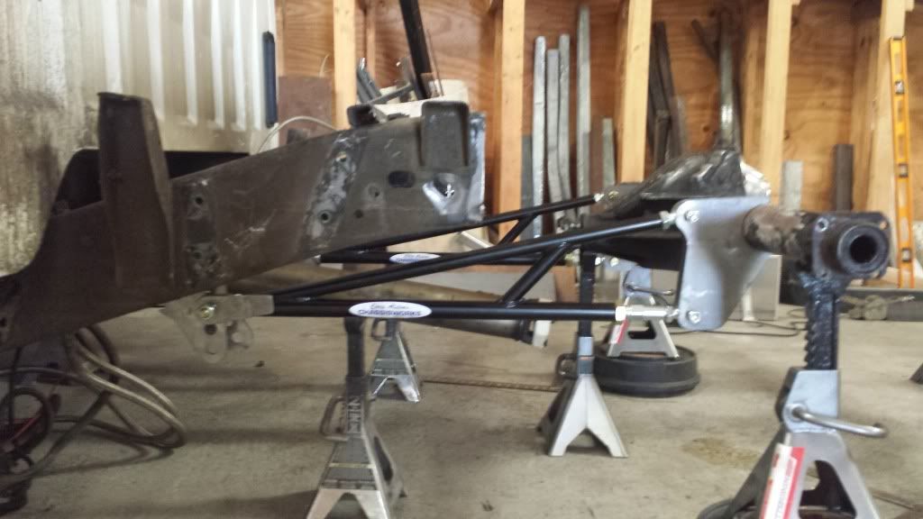

  10. #240
    1,550
    I got to do a little work to the truck. It takes a lot of measuring and remeasuring and prep so not too much has been done but it's getting there.
    Next up is the ladder bar crossmember then the frame rails and shock mounts and crossmember
