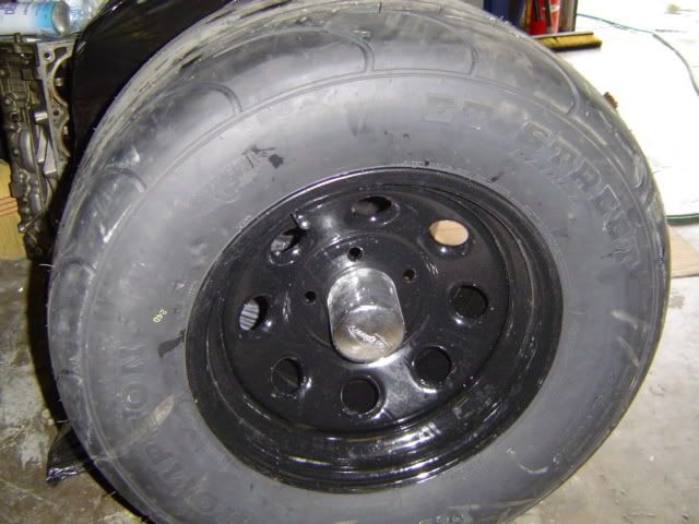

    I got me some 325/50 15in E/T steets for my 78 beater. I hope they hook&#33;&#33;&#33;
