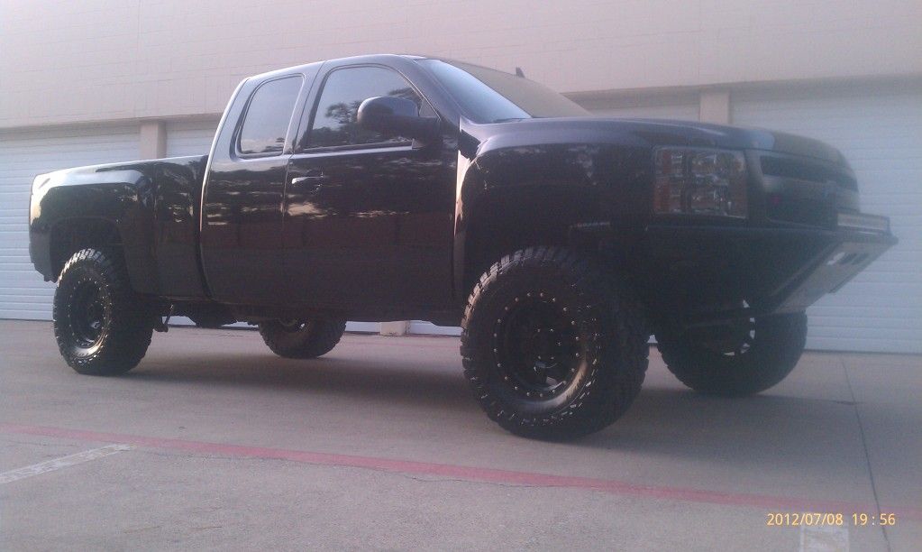

Couple pics from yesterday
http://i1187.photobucket.com/albums/...d/IMAG0603.jpg
http://i1187.photobucket.com/albums/...d/IMAG0607.jpg
It has a k&n coldair intake and magnaflow exaust with a turn down. I changed the gears to 4.10 and run a crappy edge programmer. I plan on running some long tubes from calspeed and a cam not sure which just yet and getting a custom program. I also want to change a couple thing in the tranny. I'm looking at getting the five planataries gears, getting the red larger band, a corvette servo and bumping the line pressure up. Suspension is king coilovers with Camburg upper control arms, cst spindles and I pulled the sway bar. Rear is king piggybacks with deaver f87 leafs and gmr shackles. Rolls on 35x12.5r17 toyo mt and method race wheels.
