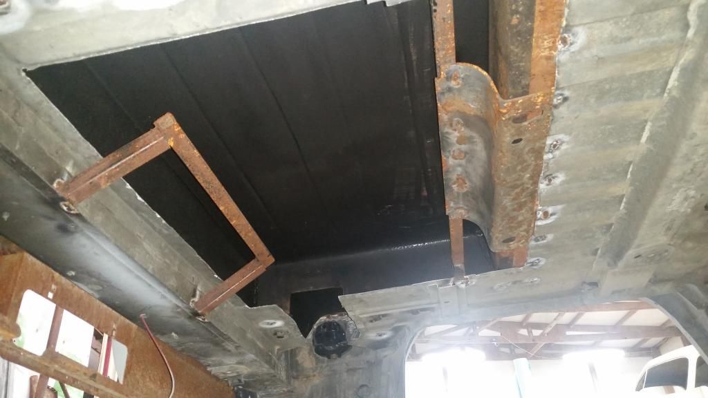

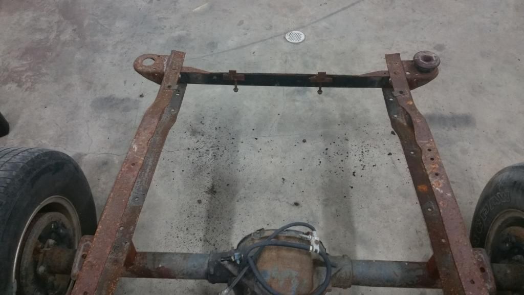

    ok stupid thing here. Can you tell me how the fuel tank actually mounts. I mean i know that it used straps and slips in a bracket at the front and bolts up in the back but are all the attachment points on the frame or body or both?
    The guy who i bought it from raised the tank and the straps fronts are on the body and the bolts are on the back but i have no clue if this is thee way they mount from the factory. Here are a few pics.

    Yes, that is how it mounts.
    The tabs have a T shape that slides in the holes in the bottom two pictures and they bolt to the two bolts in the first picture.
    ok i knew how they mounted with the t slots and the bolt mounts i just was not sure that they mounted on the body and on the frame? Any idea on how to remount the shocks since they cut off the upper mount that they shocks would normally mount into?
    Thanks for the help to clarify tho. for some reason i thought that the t slot and the bolts of the mounts were all on the frame.
    Also would you happen to have a picture of one or yours by chance if you have one. I am trying to find out the angle and make sure the tank angle is right on mine since i didnt do it?
