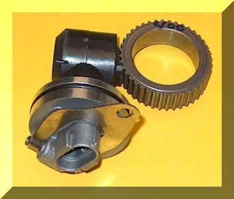

    5 dollar speed sensor. My brother waited 4 montgs maybe longer cause thought it was a bigger deal. Then greg at phx transmission pulled a electric driven speed sensor used off the shelf and ten mins later it was working.

    Its the exact sensor eclb speaks of but not that brand. He literally gave it to me. Cause said it wasn't worth the paper work. But e did have my saab for a long freakin time.
    http://i22.photobucket.com/albums/b3...0/HPIM1532.jpg
