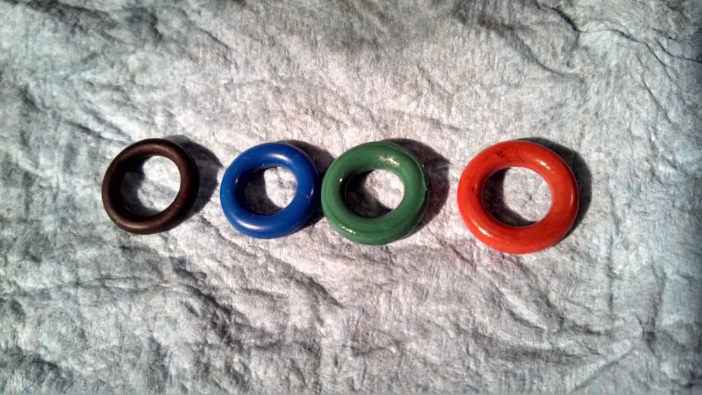

    Also, it sounds like you have the wrong o-rings. They should spin if forced, but definitely not too easily.
    Check all the o rings I just went through!

    great info thanks man, im going to just order some new orings. the ones i got a gm ones they are black not sure the part number. im going to mess with this on my next days off. last night i took the broken rail out and installed the new stock one i got, and though everything was good but the back two injectors were leaking alittle were the injector meets the rail. does anyone have any pictures of how they have there spacers and what the angle of the injectors should look like.
