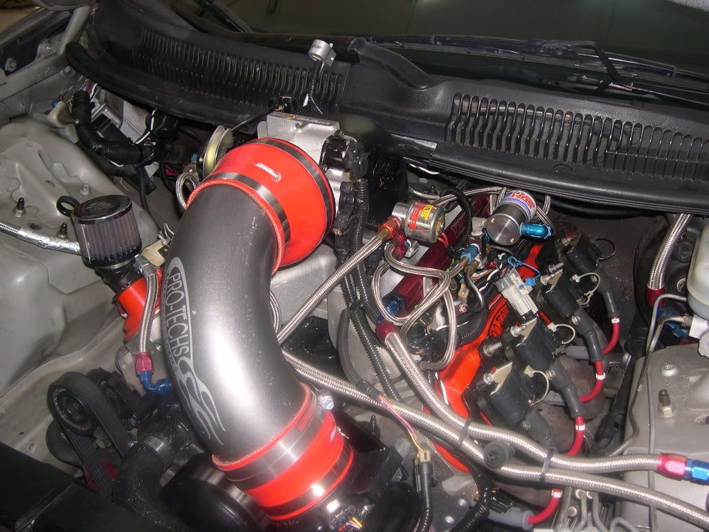

    no pics of the truck yet Ill get some this week at street night at the track but heres
    my new topend for the camaro for the 440 LSX
    camaro with 418 injected
    camaro with 418 carb
