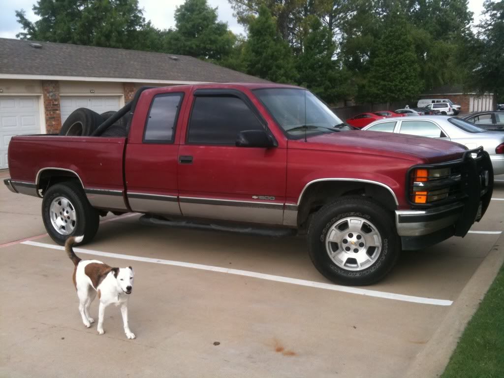

    My truck started out like this:
    minus the wheels

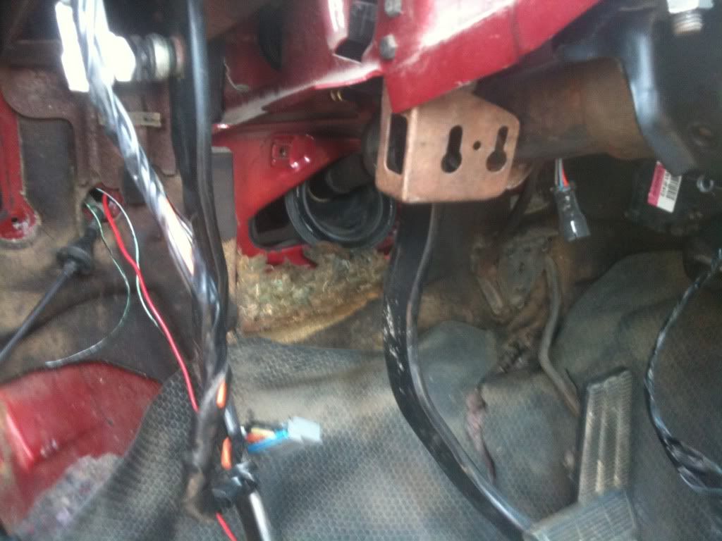

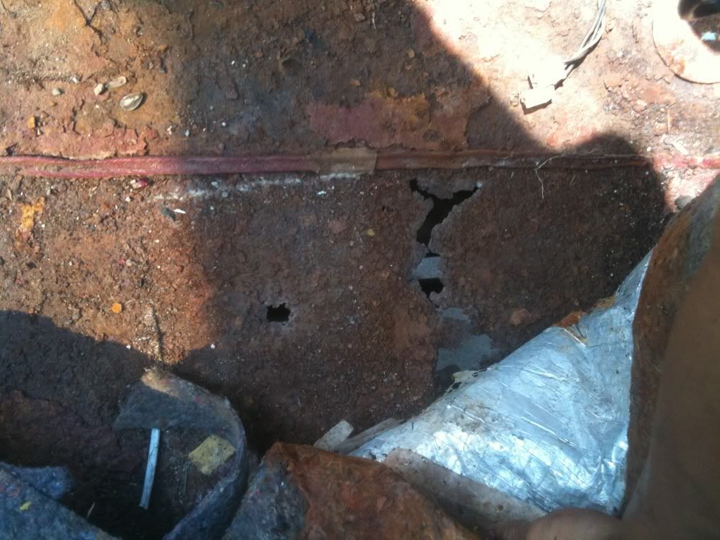

    I drove on this for over a year. I did the dash swap from a 1998 Suburban. This is where I found a whole bunch of problems. The floor board was rusted completely through. For the dash swap, the steering columns were different. The 90 utilized a huge hole to seal the column whereas the 98 used a smaller seal. This left me with a huge hole that I didnt seal. When finished with the interior swap, the noise decibels where fixed by turning up the radio. I never got around to fixing the flintstone floorboards either.

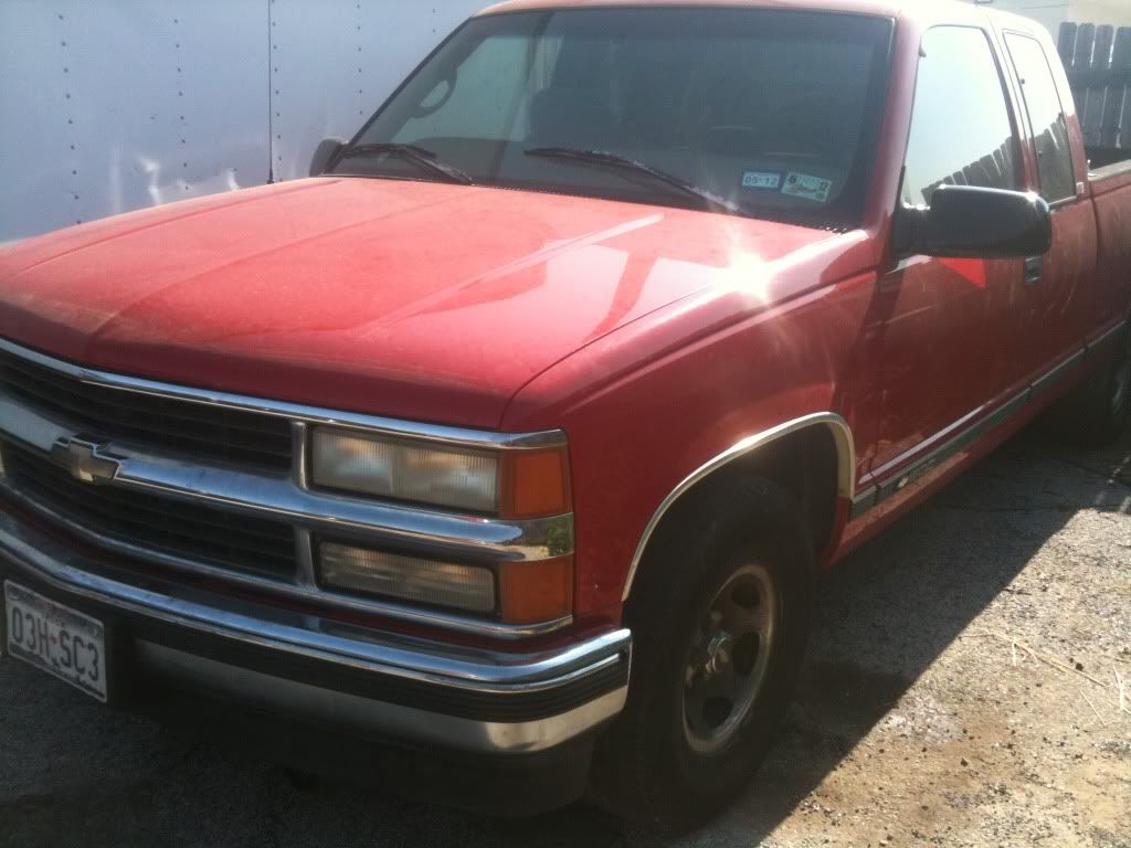

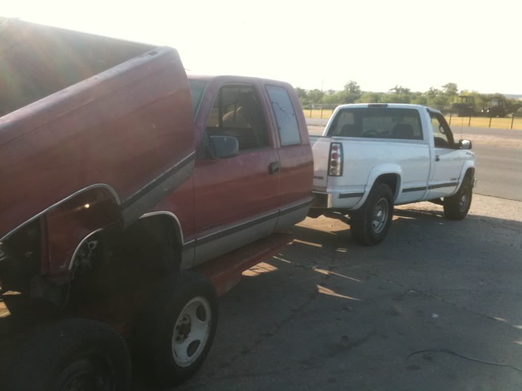

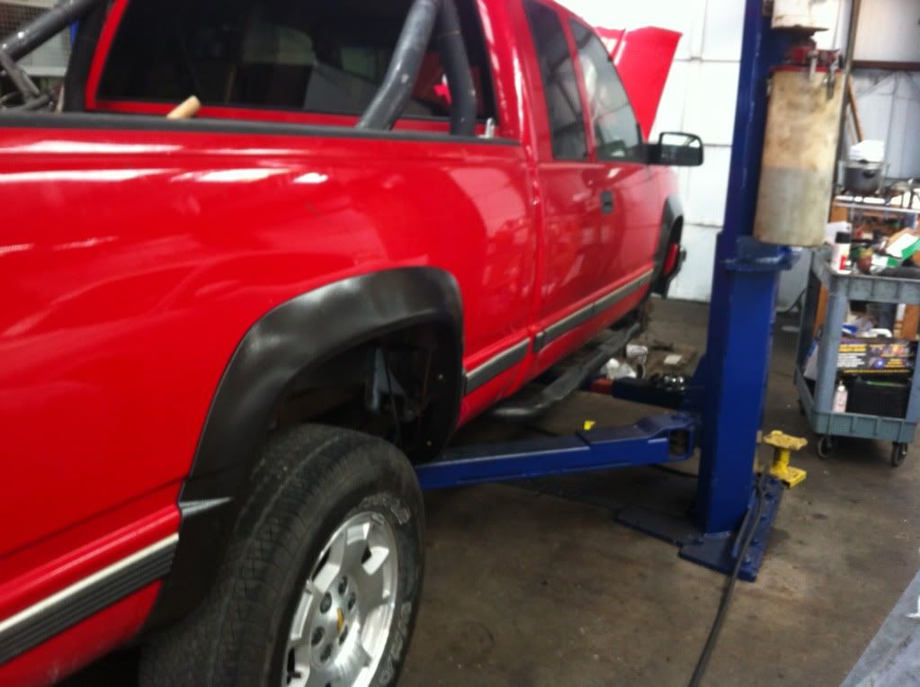

    After searching high and low I found a 1997 c1500 ECSB with a rod knock. The body was clean with no rust and the interior was mint.

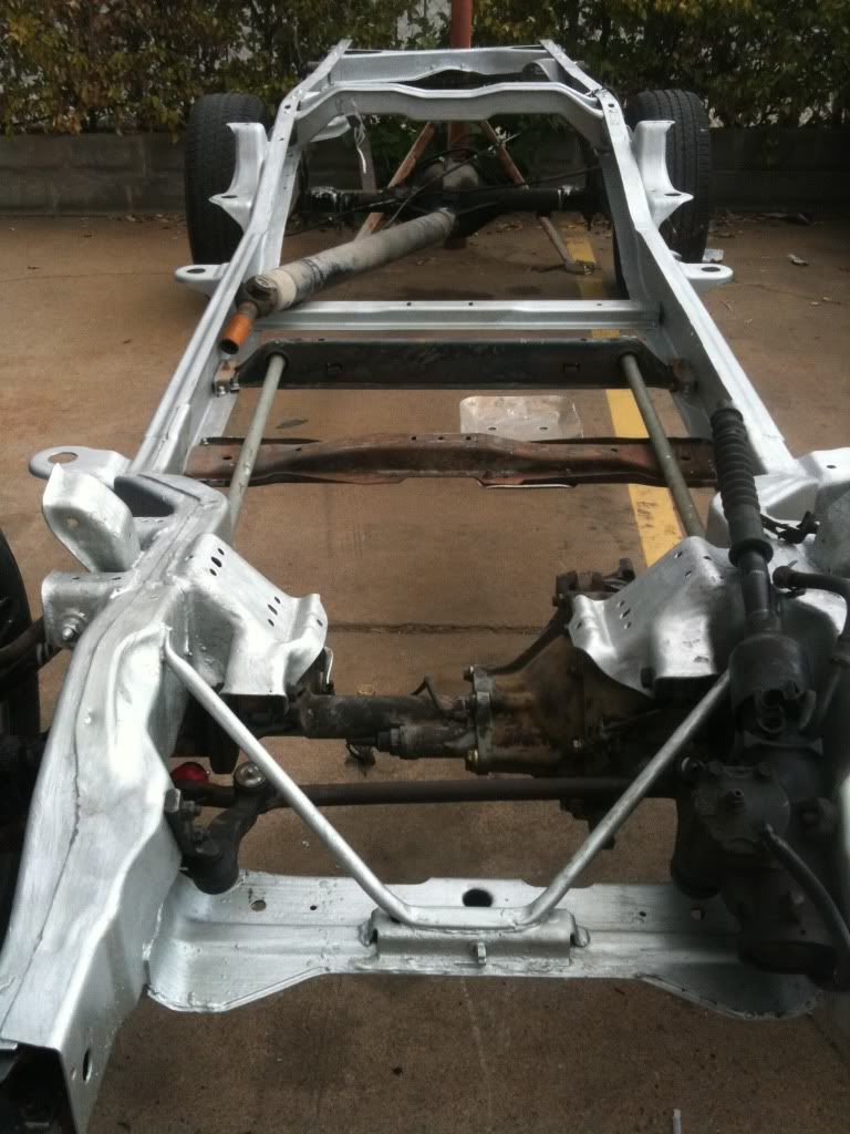

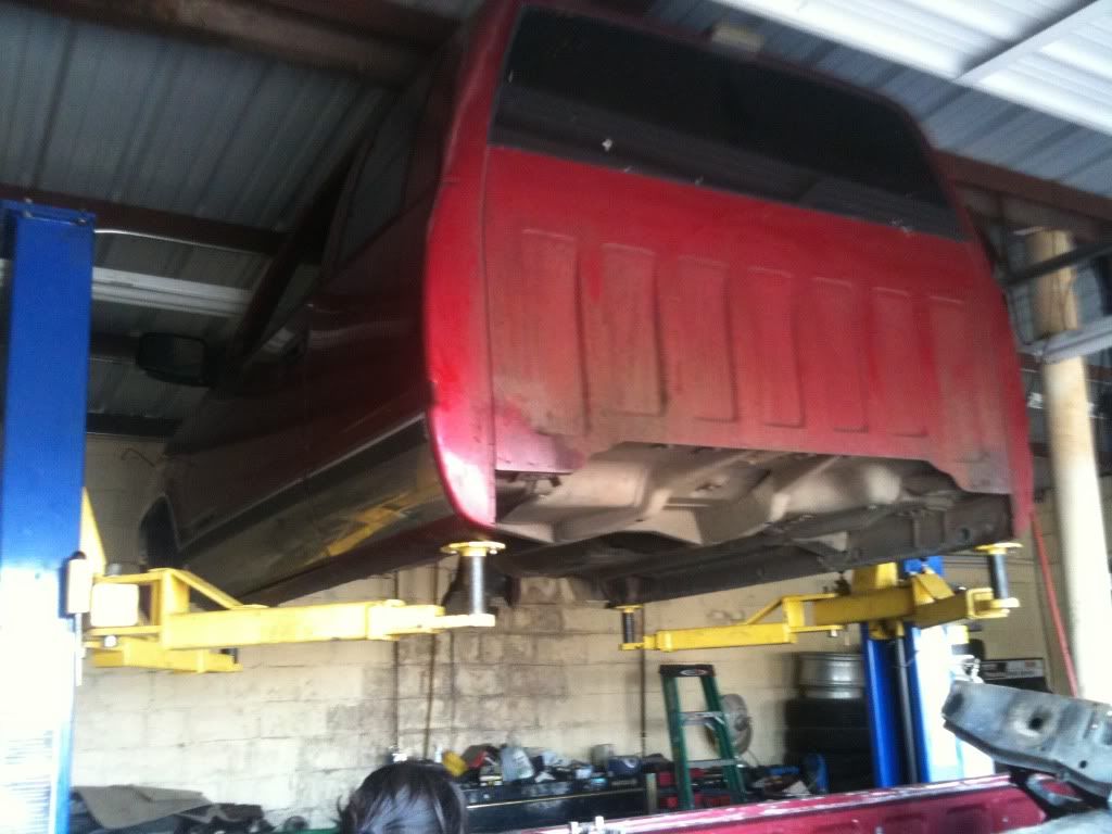

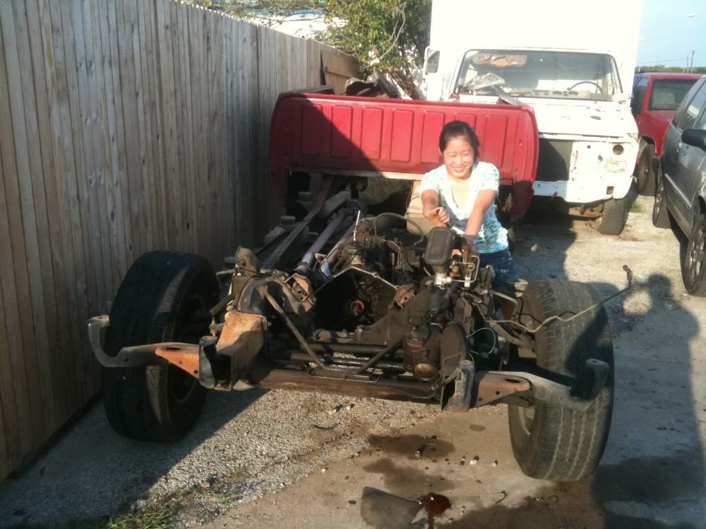

    I was adament about keeping the 4x4 so the frame swap process began. I got to thinking that it would take too long to do so decided to do the engine part first that way I can drive on the c1500 for awhile that way I can restore the 4x4 frame. I used my 1990 shortblock and the vortec top end. This worked for a couple of months but soon the tired block said no no and locked up. I slapped myself silly and cursed at why I didnt just rebuild it. This is when I my fiance said my only choice is to go LQ4 or throw away the whole thing. She said do it right or dont do it at all. So the build process was under way.
    Frame restored and thanks to MAGIC PAINT my frame is blinging.
    bye bye old buddy you will never be forgotten

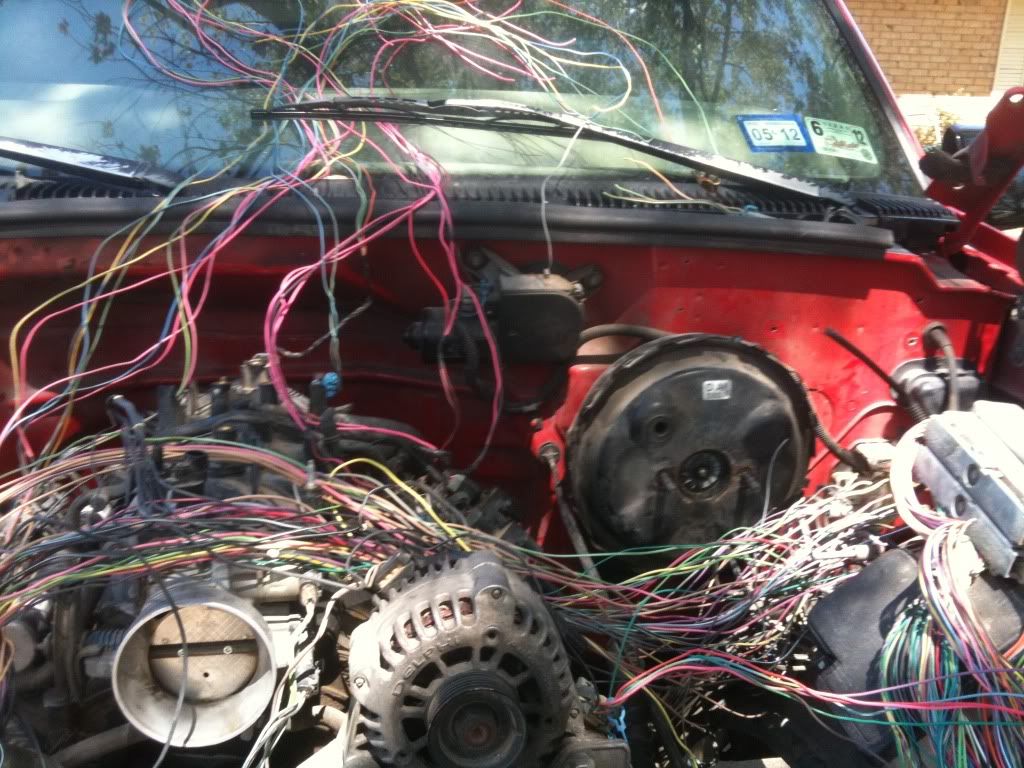

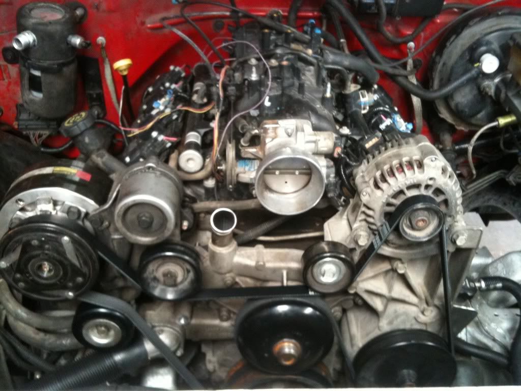

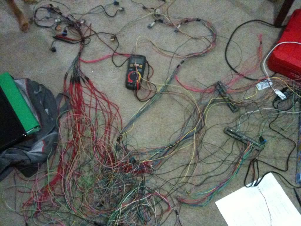

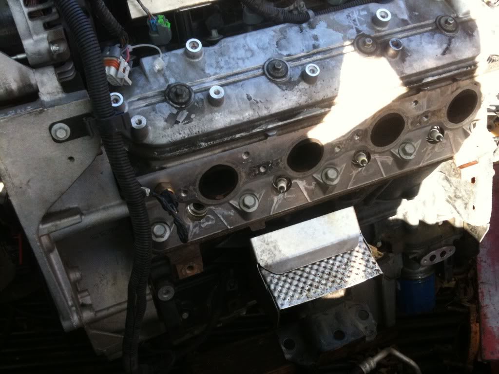

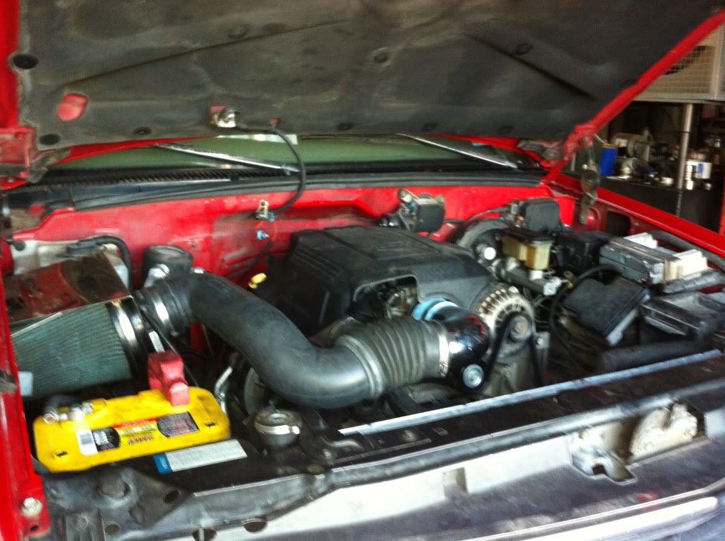

    Surgery was underway and everything seemed to be flowing smoothly until I got to the transmission. The NV3500 was ok but power seemed to be debatable. I started looking for the NV4500 but price got way up there. I found a guy with a wrecked 2004 Silverado and after some persuasion I ended up getting his 60,000 LQ4 WITH yes WITH the NV4500 for a whopping $900. The LY5 was out of there and the LQ4 assembly went in. I searched high and low there was no way I was going to pay 700+ for a harness so thanks to LT1SWAP.COM I dove in.

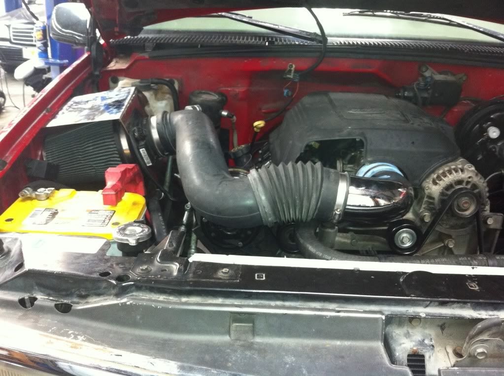

    Started up on the first try!!!!!
    I put in all the bushings mounts and put everything back. I had to rig up some type of intake. Four core radiator and dual flex-lite fans.
