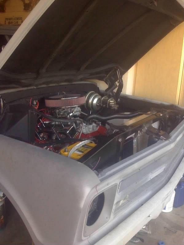

    This was when I had my 327 in it and its since been torn apart. Right now the frames being boxed and dimple died. Hopefully in the next couple weeks I can have the motor and trans mocked up and build some crossmembers. The rear links are drawn up ready to be cut on the plasma cam. Havent started the A arms yet. Swapped the 12 bolt for a 14. Still need reservoirs and air bumps. Have a 4L65E but im going to sell it and get a th400.

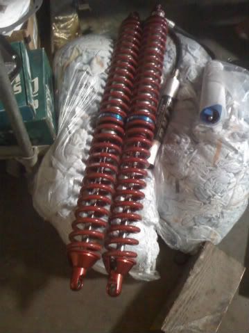

    dang it man. what are you putting the shocks on? a 12" lifted truck
    Nov 2006
    Elk Grove, CA
    211

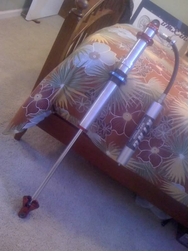

    No they are for long travel. For jumping in the desert and what not. 16" of shock travel placed in the right geometry can yield up to 22" at the wheel
