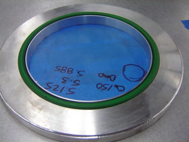

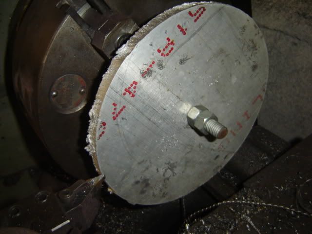

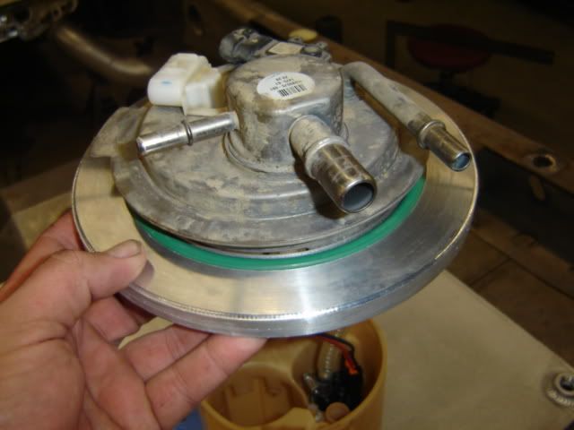

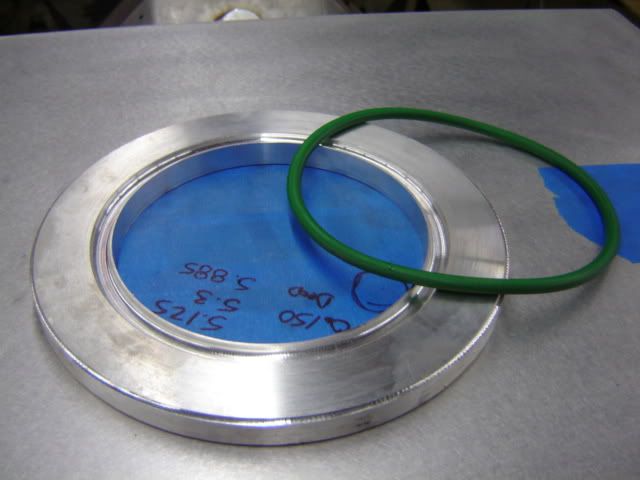

Here is the peice that we machine to adapt the stock sending/fuel pump unit to the fuel cells. Makes maintenance a little easier on the newer vehicles. This peice will be TIG welded to the top of the cell along with a filler neck.
That's a "super new" style sending unit. It's the gawd-awful offset unit that when equipped with emissions (LOL), has a line hooked to it INSIDE the tank.
