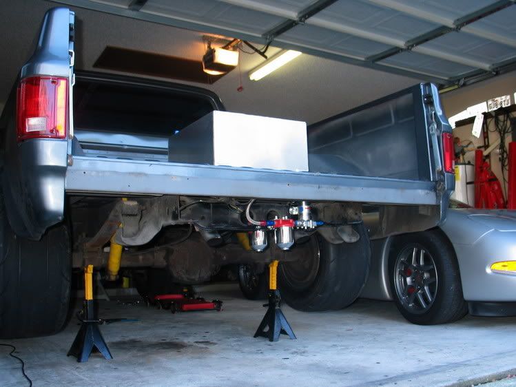

    Since I'm trying to plan as much as possible before I dive into my swap, i'd like to know how those of you running fuel cells are plumbing the fuel system for LS1's etc...
    I set up my truck earlier this year for a sbc and i'm running a cell currently with a Holley 130gph mechanical pump for the motor and a Holley "blue" elec pump as standalone for the nitrous. Since obviously my mech pump will be replaced by another electric which one would you guys recommend?
    Thanks.
    86 C10 swb 355/350 trans for now
    Oct 2005
    Baton Rouge, LA
    997
    I've been recommended anything from Walbro 225lph's to Aeromotive's equivalent pumps. I managed to find a great deal on a private sale of a pump that came with a Procharger kit that's an equivalent to Walbro's 255lph.
