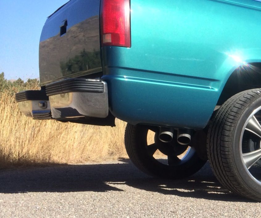

    I built mine as well. I also did dual 3" with an H pipe using mandrel bends. Its 14" x 4" x 9" Magnaflows, I have turndowns on it as of now but they are not pictured. Here's a few pics.

    That's almost mine exactly
