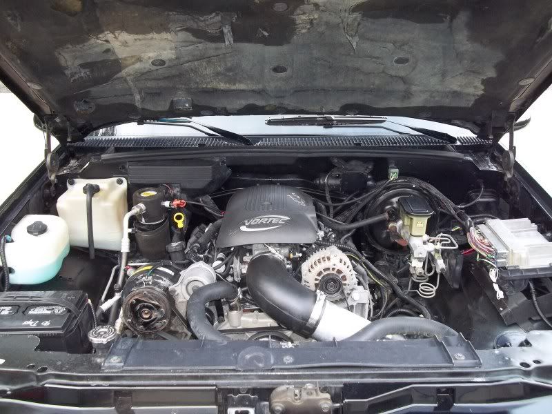

1994 Silverado 4.3 V6 to LSX swap complete

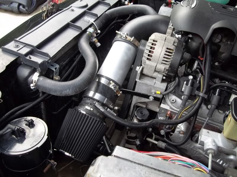

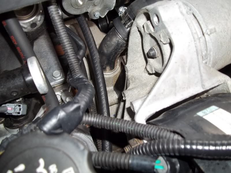

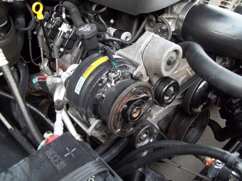

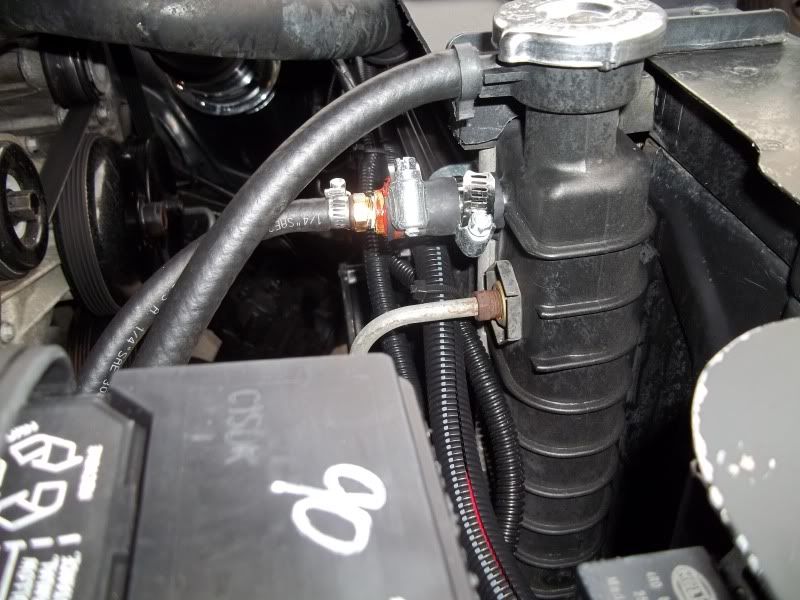

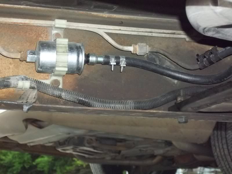

So far so good with my swap, I have about 800 miles on it and I have to contribute alot of it to the help from those on this site, just thought I'd post some pics of my swap, truck started life as a base package 4.3 V6, it had been in a hail storm sometime back and still has the dents from it, for now it's a nice hot rod to run around in and looks good from 20 feet away, during the swap we lowered it with a

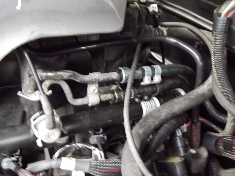

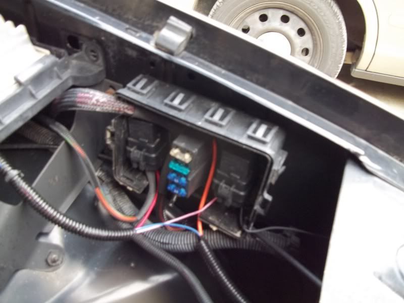

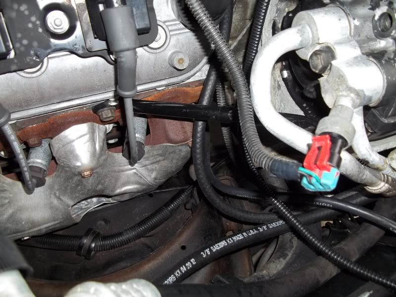

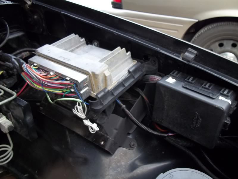

DJM 4/6 kit, donor drivetrain is from a 05 model avalanche, I swapped over to the cable drive throttle body to make things more simple. I bought my harness from nelson performance,fan harness and comp program by them also, if anyone has any questions about the swap feel free to ask, I took some closer detail pics
on the a/c bracket and fuel line setup to give those who may be working on a swap, I could not be happier with how this swap turned out, 2 thumbs up to this site and 2 thumbs up to Jon at Nelson Performance!!
Big Thanks to my friends Chris, Keith and Bill for some odd and end parts and help getting the conversion complete!!
