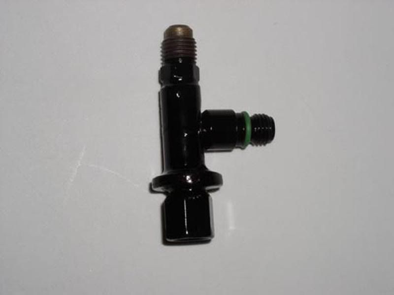

    Check out this fitting I made. I hooked up my fans to operate on a/c presure. I don't have the pin in the pcm turned on to operate the fans, so I made another fitting to go in line with the heater hose, that turns the fans on at 195. I still need a bigger alt.
    home made a/c fitting $30
    home made coolant fitting $5
    250 psi a/c switch $30 part # redot 71r6230
    coolant switch 195 $40 part # jet 60600
    34" radiator $260 from the Radiator Barn.com
    e-fans $175 ebay
    rocker switch $5 radio shack
    total out of poket $545
    http://i10.photobucket.com/albums/a1...dited-copy.jpg

    Badass!!! This is what another member and I have been discussing in the background.
    Few questions, do your fans come on at 50% power then switch to 100%?
    High side AC pressure vaires from climates, system capacity, etc. Is 250psi the best choice for an average pressure?
    Are fans off at freeway speeds provided motor is below 195°F? Or could you run a harness to control fans for 50/100% speeds and use the pressure setup to dictate when the fans kick on and off?
    Thanks, I may have to hit you up for some of this!

    IT'S A BEAUTIFUL FITTING!!!!!!
    What, I'm sure, we really want is some more detailed instructions on the specifics of how this fitting was fabricated.
    This is sweet!!!!! With Allen's harness and this pressure switch the fans would no longer activate at highway speeds when they are not needed, unless you were overheating in which case you have bigger problems.
    Sitting in traffic the fans would not cycle with the A/C and would remain on while pressure is above 250.

    I wired it to operate only # 2 fan on high for the a/c and it only runs in stop and go trafic. I could not find a presure switch lower than 250 psi, the fans turn off at 240 psi, 225 psi would be best. I can not find a dual stage switch to make the fans operate at 50% and then 100%. To make the fans turn off at a certain presure you would need to create a latching circuit and run it though a aux. low presure switch. I am leaving on vacation for a week and will give more detail when I get back.
    Thanks Nate

    Give us the low down when you return.
    I don't mind fans on at 100% when needed in town, on the freeway is another matter.
