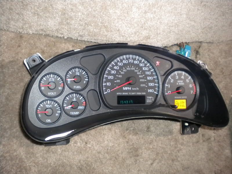

    just thinking out side the box but will a gauge cluster from a IMPALA SS (5.3 motor) work as a gauge cluster swap? i like the 7K tach and the 140 speedo and the price is nice as well

    like this?
    if so u might need the scamatics for that plug on the cluster cuz you might have to move some wires around if theres a year difference between your truck and impala
    The bolt holes look the same though

    yea! just like that. ill have to get into alldata later and check out the pin out on the impala cluster

    ya exactly thats whts wht i used all data! and it showed the pin difference between the 03 and 02 difference
